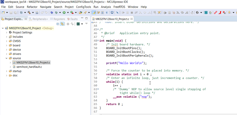

1) The PRINTF("Hello word") is not recognized. Which component do I add to be taken?

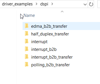

Regarding the SPI example code, after download the sdk for k02, you can find the DSPI examples at the following path:
\SDK_2.7.0_MK02FN128xxx10.zip\boards\frdmk22f\driver_examples
In addition, I am attaching the MCUXpresso SDK API Reference Manual_MK22

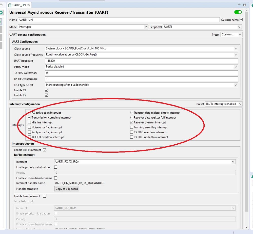

-For the UART module, I think the C code is designed to configure the BreakLin Dtetection, but the MCU expresso IDE do not allow to activate this option. I'm right?

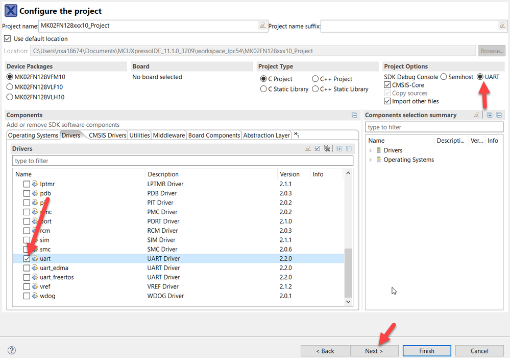

Please follow the below steps:
1. Click on New project
2. Select the MCU from installed SDK, click Next
3. In project, Options select UART and add the uart driver
4. Select Redirect SDK "PRINTF" to C library "printf", then click Finish
5. At this point, you should be able to use printf.

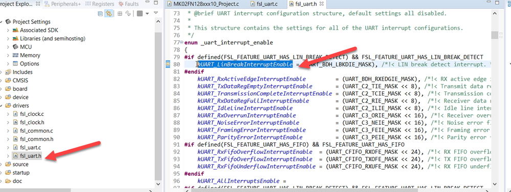

Please check the fsl_uart.h
You will find the structure with the settings for all of the UART interrupt configurations.

For the LinBreak, it is what I said. The Break Lin interrupt detection is on the c code, but on the MCUXpresso, it is not ?
3,203 Views
soledad
MCUXpresso IDE does not allow to activate this option like you previously mentioned.
