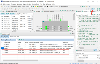

I'm trying to set up the ACMP for a LPC824 in MCUXpresso.  When I select the positive and negative inputs in the analog comparator peripheral window, is shows that the inputs are disabled.
Here's what it says: ACMP_IN3 » [25] P3[16]/J5[2]/P0_14-ADC2-ACMP_I3, Disabled
The pins are routed in the PINS window.
How do I enable the pins to work with the ACMP?

dporada
Here's my pins.
Screenshot 2023-01-11 at 7.17.04 AM.pngScreenshot 2023-01-11 at 7.17.04 AM.png

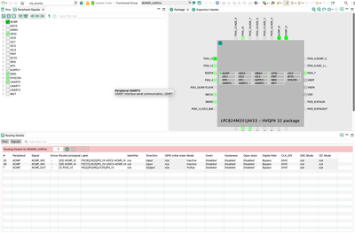

dporada
I have attached a screen shot of the Peripheral setup that has the Disabled lines.
This was not actually my problem.  My problem was that the ACMP is not powered initially.  I am surprised that the software that is used to configure the ACMP, initialize it, and set up the interrupts does not power it up.  I did not see any mention in the documentation that this is required.  I found the line of code in lpcxpresso824max_acomp_interrupt example that disables a bit that allows the ACMP to power up.
Did I miss something obvious?

ZhangJennie
Hi @dporada
You didn't configure ACMP pins. Please configure it in pin configuration tool, then you will see the pin enabled in ACMP component.

ZhangJennie
Hi @dporada
Could you please send me screenshot of the peoblem?
Thanks.
