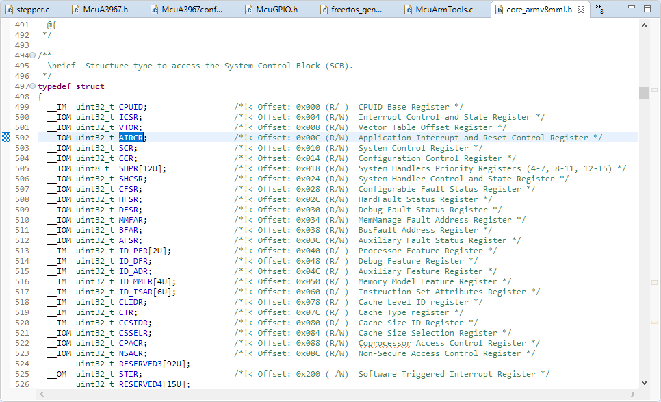

BlackNight
I'm using the LPC55S69, and there it is in the core header file:
I hope this helps,
Erich

BlackNight
I hope this helps,
Erich

vn2000
Hi Erich,
I still have a problem declaring this AIRCR register while compiling. In the mean time I found another suggestion on the Software Reset:
__NVIC_SystemReset()
This works fine for me. So that's all I need. Thanks.
