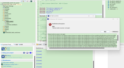

Dear all
I use my FRDM-K32L2B3 board with MCUXpresso IDE v11.6.1_8255 Windows 11
when I build example "hello world', It works  as my wish.
but when I click "Debug" and want to burnning in my board, someting happened
  • RedlinkServerException Cannot write to server: not open
an error appeared, so can anyone help me?
This is my first time using MCUX, and I hope you can explain it in detail
Thank you !!!!!!!!!!!!!!!!!!

Hello @NicoleYuWenlu,
There is a lot of reasons that can cause that error:
  • The first reason could be related with your firewall, it may be preventing the debugger from connecting to the server. So, please double check it.
  • If that doesn't work, it could be a bad initialization of the RedLink Server, please click on the following icons in the Toolbar. The first one, will provide you a status of the RedLink Server, and the second one will try to boot it; after that, please try to Debug once again.
  • If the issue still persists, you could delete the .metadata folder under MCUXpresso IDE workspace directory; then, debug your project.
  • Finally, if all the steps above don't work, you might want to reinstall the MCUXpresso IDE.
Hope any of this works out for you.
