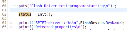

To further pinpoint the problem, I ran the SPIFI driver code from the Example directory in the MCUXpresso install folder. It crashes with a hard fault (see stack below), but gives the following output.
[MCUXpresso Semihosting Telnet console for 'LPC5460x_SPIFIdriver_Generic LinkServer Debug' started on port 49341 @ 127.0.0.1]
Flash Driver test program starting
SPIFI driver : LPC5460x Generic SPIFI Sep 14 2017 07:29:17
Detected properties
- SPIFI size : 65536 KB, 64.00 MB
- SPIFI ProgramPage size : 256 bytes
- SPIFI sector size : 64 KB
- Detected device : (null)
The hard fault occurs during execution of the instruction pastedImage_13.png , which reads eight words from pastedImage_14.png.
What can cause the driver to fail that way?

I have just figured out that the hard fault is due to the flash driver not caring about the return value of Init().
This would cause a hard fault, because (I guess) the peripheral is not clocked or powered. The reason that this is relevant at all, is that the device we are using now is actually not supported, because it is a S25FL256L.
I have now implemented support for the device and at least the test application is working. Will check with the compiled driver next.
