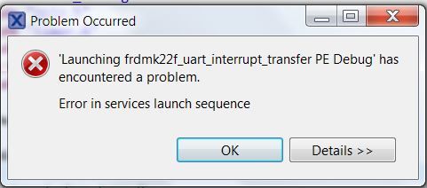

we have tested various peripherals using the Freedom Development Board FRDM-K22F .
Now we are using NXP K22DN512VLH5 micro controller for our project and we wanted to load the sample program  into K22 which is existed in our custom board .
We are unable to program  by using PE micro Rev B and Rev D  .
I have followed the instructions provided in PE Micro's blog  : PEMicro Blog  but still unable to program it .

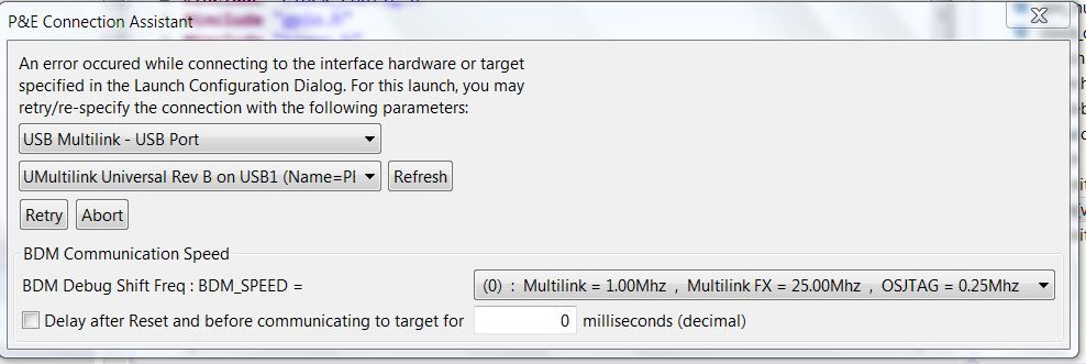

In the Debugger config , under Select device we are unable to find "K22DN512VLH5" the close match we could find is "K22DN512M5" .
Selected "GDB PEMicro Interface Hardware Debugging (DSF) Launcher" as preferred launcher.
All the power supply lines in our custom board are properly working , 3.3V is provided to the controller and the JTAG lines from controller are also properly connected to the PE Micro .
Please check the steps and Error message we are getting :1.JPG
Is there something i am missing in between the config selection because of which i am unable to program it ?
Any helping related to this will be great .

Hi Analogics Tech India Limited
Frdm-K22F doesn't have a K22DN512VLH5, it has a K22FN_12, and these two MCUs are different, you cannot load a program of the frdm board in a K22DN_5. I recommend you check the TWR-K21D50 code examples, they are compatible with this device.

analogicstechin
Thanks Jorge Antonio Alcala Vazquez I did try programming My custom board with K21DN50 SDK and it works Seamlessly ,Thanks for your support ,.
