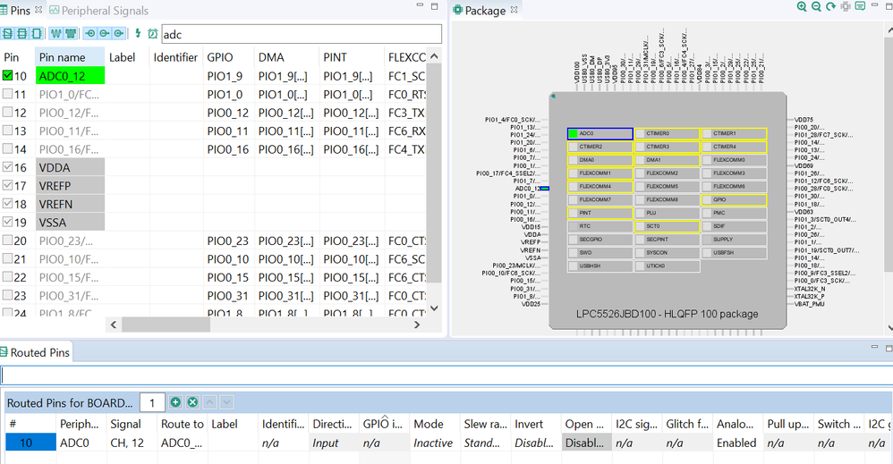

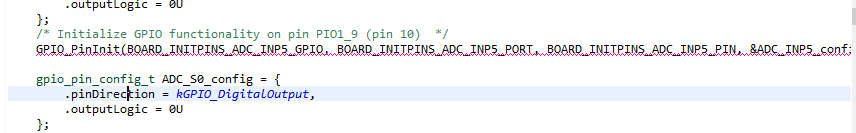

Im using MCU expresso 11.1.0 to create a setup voor a LPC5526JDB100 the pin setup works ok for almost all pin's but when I set one of the ADC pins  pin10 as ADC0_12 input in the pin tool and generate code for it the code won't compile.
It tries to init the pin as normal IO pin.
Any idea what I'm doing wrong?

Thank you for reporting this issue. There is issue in code generation script that causes that when label and identifier is used for ADC pins in Pins tool then the GPIO_PinInit() code is updated to use GPIO symbols expected in pin_mux.h, however, the symbols are not generated to the header. Attached please find patch resolving the issue.

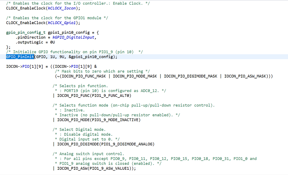

Can you help me describing me the configuration you put on the pin? It should look like this:
I compile it and got no errors on my side
