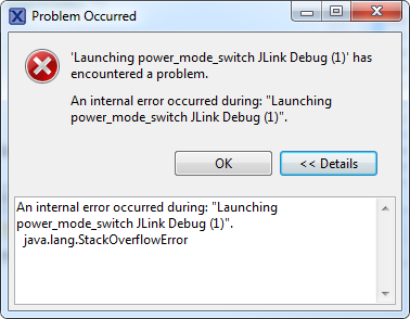

C++ project
Problem:
MCUxpresso crashes with the error message:
Internal Error
A stack overflow error has occured.
You are recommended to exit the workbench.
How to Reproduce:
After starting a Debug session, or while hovering over code while debugging.
I have asked for a solution for this:
Case:00221977: A stack overflow error has occurred. While hovering over code while debugging.
I tried the suggestion to modify the mcuxpressoide.ini, but that did not work
-Xss1m -> -Xss10m
I realize this is an eclipse error, but does anybody have a solution or fix for this problem?

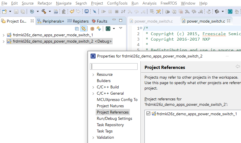

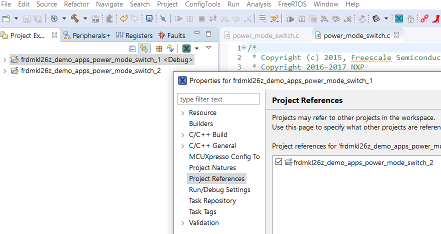

We've done some more experiments in order to track down the issue you're seeing. We tried v11.0.0 and v11.0.1 with SDK 2.2.0 for FRDM KL26Z. There's really no problem with regards to debugging the default SDK example projects. However, when making some changes to the projects, the problem you describe starts showing up. So, please let us know which of the situation below applies in your case:
 1. Two 'power mode switch' demo apps (can be any other default/custom projects), each one having a reference to the other one.
2. Using the 'power mode switch' (can be any other project) SDK example, force the 'Debug' build configuration reference the 'Release' build configuration.
The workaround for the above mentioned use cases is to close the Global Variables view and use the Expressions view to monitor any global variables instead.
Even if you're not in one of the situations described above, would you please close Global Variables view and check if the problem still appears? Please let us know.

This problem happens with ALL versions of MCUXpresso, on ALL PCs, on ALL builds, with ALL versions of j-link, with ALL new and imported projects!
I restart MCUXpresso one hundred times a day! That is no exaggeration! We spend most of our time restarting MCUXpresso.
Start Debug, crash, restart,  Debug, crash, restart,  Debug, crash, restart,  Debug, crash, restart,  Debug, crash, restart,  Debug, crash, restart,  Debug, crash, restart,  Debug, crash, restart,  Debug, crash, restart,  Debug, crash, restart,  Debug, crash, restart,  Debug, crash, restart,  Debug, crash, restart,  Debug, crash, restart,  Debug, crash, restart,  Debug, crash, restart,  Debug, crash, restart,  Debug, crash, restart,  Debug, crash, restart,  Debug, crash, restart,  Debug, crash, restart,  Debug, crash, restart,  Debug, crash, restart,  Debug, crash, restart,  Debug, crash, restart,  Debug, crash, restart,  Debug, crash, restart,  Debug, crash, restart,  Debug, crash, restart,  Debug, crash, restart,  Debug, crash, restart,  Debug, crash, restart,  Debug, crash, restart,  Debug, crash, restart,  Debug, crash, restart,  Debug, crash, restart,  Debug, crash, restart,  Debug, crash, restart,  Debug, crash, restart,  Debug, crash, restart,  Debug, crash, restart,  Debug, crash, restart,  Debug, crash, restart,  Debug, crash, restart,  Debug, crash, restart,  Debug, crash, restart,  Debug, crash, restart,  Debug, crash, restart,  Debug, crash, restart,  Debug, crash, restart,  Debug, crash, restart,  Debug, crash, restart,  Debug, crash, restart,  Debug, crash, restart,  Debug, crash, restart,  Debug, crash, restart,  Debug, crash, restart,  Debug, crash, restart,  Debug, crash, restart,  Debug, crash, restart,  Debug, crash, restart,  Debug, crash, restart,  Debug, crash, restart,  Debug, crash, restart,  Debug, crash, restart,  Debug, crash, restart,  Debug, crash, restart,  Debug, crash, restart,  Debug, crash, restart,  Debug, crash, restart,  Debug, crash, restart,  Debug, crash, restart,  Debug, crash, restart,  Debug, crash, restart,  Debug, crash, restart,  Debug, crash, restart,  Debug, crash, restart,  Debug, crash, restart,  Debug, crash, restart,  Debug, crash, restart,  Debug, crash, restart,  Debug, crash, restart,  Debug, crash, restart,  Debug, crash, restart,  Debug, crash, restart,  Debug, crash, restart,  Debug, crash, restart,  Debug, crash, restart,  Debug, crash, restart,  Debug, crash, restart,  Debug, crash, restart,  Debug, crash, restart,  Debug, crash, restart,  Debug, crash, restart,  Debug, crash, restart,  Debug, crash, restart,  Debug, crash, restart,  Debug, crash, restart,  Debug, crash, restart,  Debug, crash, restart, ...
Please let me know what else can I provide that can help you all sort this problem out.
Bruce

bgraham
NO DIFFERENCE. Any other ideas?
See repro steps below.
This happens every time I try it.
This happens with every PC at work.
It is SO easy to reproduce, so why can't you folks fix it?
Bruce Graham
Senior Software Engineer
TechnoSoft Innovations, Inc.
[email protected]
900 Perimeter Park Drive, Suite C
Morrisville, NC 27560
Phone 919-337-0866 Ext 104
Installed
MCUXpresso IDE v11.0.1 [Build 2563] [2019-09-01]
(c) Copyright 2006-2019 NXP
OS: Windows 7, v.6.1, x86_64 / win32
Java version: 1.8.0_201
Deleted *.launch file.
Compiled Debug configuration.
Using the Quickstart Panel, created new Debug configuration.
Started the debugger.
Stopped the debugger.
Edited some code.
Compiled.
Started the debugger. See error dialog below.
