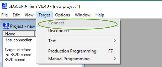

LPC845 programming failed using GDB Jflash ,
when I choose MUC device for LPC845M301.
Please look at picture .Who can tell me how to program to LPC845 ?
3,711 Views
ZhangJennie
Hello Yangyue,
In your screenshot, the MCU is set as LPC824. While your target is LPC845? Please change it to the right target.
I am not sure of J-Flash v6.20 support LPC845. But I use J-Flash v6.4, it can support LPC845 without problem.
Please make sure you have board successfully connected before program/erase.
