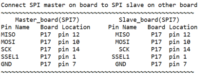

I'm testing SPI on new eval board LPC55S69, I'm trying to set this board as master with an external device , no one of examples provided by the SDK succeed to work ! is that related to peripheral tool which is not provided for this Device, or what?
 I'm using SPI7 with pins mentioned in photo attached , connected to  an external device set as slave!

I'm using the last SDK 2.6.2, I have two eval boards LPC55S69, I set one as slave with demo example (lpcxpresso55s69_spi_dma_b2b_transfer_slave) and the other one as a master with lpcxpresso55s69_spi_dma_b2b_transfer_master example, I ran the slave before then the master and the transfer fail as the console shows, I did not change anythings on both codes!

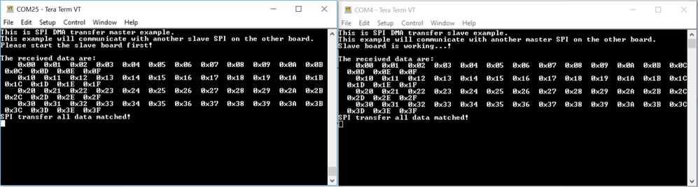

I've ran the examples without any modifications and had no problems.
Can you please check that the configuration of your connections are correct as shown in the readme file.
My results:
