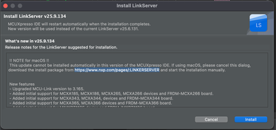

RESOLVED, answering myself.
There is a LinkServer update (25.9.134) that fixes the issue.  It is not automatically installed with MCUXpresso IDE 25.6.136 for MacOS.  You must manually download and install it.
In the IDE, go to Preferences->MCUXpresso IDE->LinkServer Options->Check for LinkServer updates.  Then go to the web page shown and download the update.
