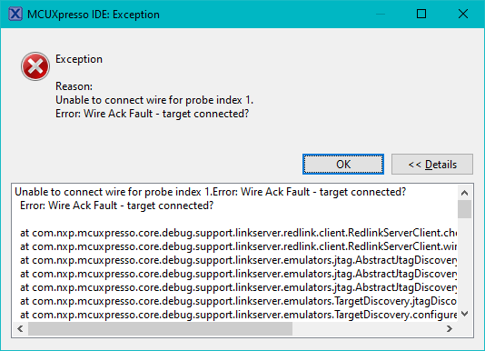

I have just recently installed McuExpresso 10.3.0. Previously I was using McuExpresso 10.0.2. When I downloaded the latest SDK for FRDM K64 and tried to debug a demo example, I got this error.
Failed on connect: Nn(05). Wire ACK Fault in DAP access
I dont understand what is wrong. Kindly, help me with this.

Hi Saad,
First, we need identify this issue is only on one project or a common issue for all project.
- please create a NEW project in a NEW workspace, see how the connection works.
- please test your project in a NEW workspace, how does it work?
If both of above can't fix the issue, I suggest you update your K64 firmware.

I have done what you said to me.
Now I am getting the following error
15: Target error from Commit Flash write
Cannot halt processor.
Debugging context: frdmk64f_lwip_tcpecho_bm Debug

The issue has been resolved.:)

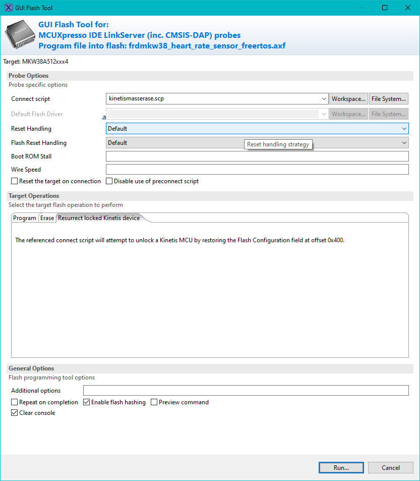

I found the problem was that the MCP was locked, It's a simple way of unlocking a MCU in MCUXpresso that I thought I'd share with other novices so they can get going again easily:
Step 1: Open the GUI Flash tool
Step 2: Choose Resurrect locked...
Step 3: Hit Run.
In a moment the MCU will be unlocked and ready for more programming action!

In mcuxpressoide-11.7.1_9221 there is no such thing as "Resurrect locked ..."
12,858件の閲覧回数
ErichStyger
Specialist I
As the screenshot indicates:
"Resurrect locked Kinetis device": this feature exists for Kinetis devices only.
If you happen to have an LPC: try erasing the flash from the bootloader, or you might use a recover script like described here: https://mcuoneclipse.com/2023/07/25/linkserver-scripting-and-how-to-recover-mcus-with-a-script/

Hi all,
I am young in this forum
Meanwhile When I perform this
I have the following result
The detail infos in the console:
Executing flash operation 'Resurrect locked Kinetis device' (Resurrect locked Kinetis device) - Mon Mar 01 16:30:41 CET 2021
Checking MCU info...
Scanning for targets...
Executing flash action...
MCUXpresso IDE RedlinkMulti Driver v11.3 (Jan 11 2021 16:41:13 - crt_emu_cm_redlink.exe build 9)
( 0) Reading remote configuration
Wc(03). No cache support.
Found chip XML file in C:/Users/binard/Documents/MCUXpressoIDE_11.3.0_5222/workspace/frdmkw38_heart_rate_sensor_freertos/Debug\MKW38A512xxx4.xml
( 5) Remote configuration complete
Reconnected to existing LinkServer process.
Connecting to probe 1 core 0 (using server started externally) reports:
'Ee(42). Could not connect to core.'
Retrying...
Server OK but no connection to probe 1 core 0 (after 3 attempts) - Ee(42). Could not connect to core.
============= SCRIPT: kinetismasserase.scp =============
Kinetis Mass Erase Script
Error: Wire Ack Fault - target connected?
Assert NRESET
Reset pin state: 00
Error: Wire not connected
Power up Debug
No Debug Power
============= END SCRIPT ===============================
Failed on connect: Ee(42). Could not connect to core.
No connection to chip's debug port
(100) Target Connection Failed
Unable to perform operation!
Command failed with exit code 1
