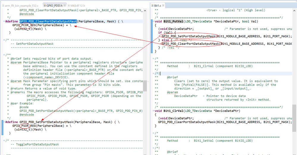

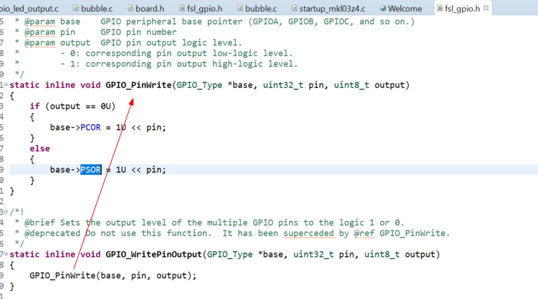

Hello shaul,
Thanks for your description, I check the code , there is no difference between the two functions,
all configure the two regsiters "PCOR" and "PSOR"
In Processor Expert of KDS:
In SDK:
