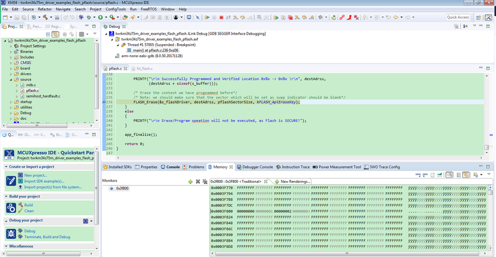

Now we successfully  able to access the flash and save data with creating memory blocks.
But  at the time of  erase memory block individually, The whole memory with all blocks are erase same time.
As per our application, Memory of single block has to clean and update as per the function used.

    I have test our SDK flash project in our TWR-KM34Z75M board, it works OK, TWR-KM34Z75M chip is just MKM34Z256VLQ7, the same chip as you.
   1. Please download the newest SDK code from this link:
Welcome | MCUXpresso SDK Builder
   Chose the TWR-KM34Z75M board, then generate the code and download it.
  2. open the project in folder: SDK_2.2_TWR-KM34Z75M\boards\twrkm34z75m\driver_examples\flash

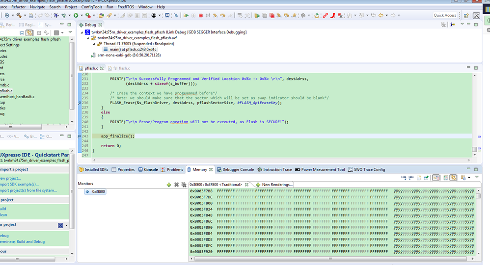

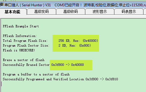

  3. Please check my following test result, you can find sector erase is correct, it won't erase the whole flash block.
You can find other flash address also have data, so the flash sector erase works OK.

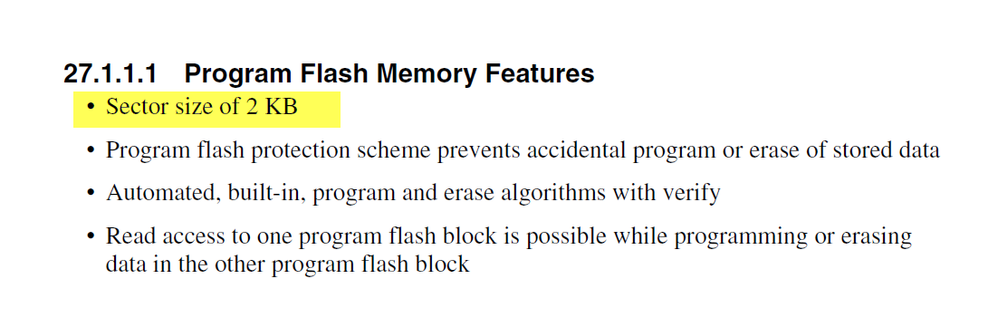

Please note, the Flash sector size in MKM34Z256VLQ7 is 2KB, it is 0X800, you can't define it as 0x100, even you define it as 0x100, it will still erase the 0x800 flash sector.
Please check the reference manual:
So, I highly recommend you check the KSDK sample code on your side directly.
