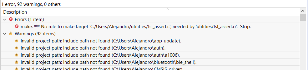

I am using MCUXpresso trying to debug one of the examples: "display_sensor". I am trying to learn how to use the I2C interface to communicate with a sensor. The issue with this example is that when building I get the following:
I have updated the paths at project's properties, and I also used the clean option with no improvement. What can be wrong ?

Hello Alejandro Abraham ,
In order to help you, please share me the below information:
Your chip part number? What about the project, a demo or create by yourself?
Which version of MCUXpresso IDE you used? Attached your project.
Thanks.
Alice

The problem seems to be that the include files are copied to the "C:\User" folder rather than to the workspace. Once I copy all the include folders manually into "C:\User" the project compiles without that error. Now it shows the following error:

Hello Alejandro,
 When import project into MCUXpresso IDE, don't check "Copy projects into workspace".
I test on my side, there is no error. Please look at my video in attachment, it shows the detail steps.

Yes I have done that and if you compile directly there is no error. The issue arises when I go to Config Tools and update the drivers. Then the errors appear. How could I use the config tools without errors then ?

Hi Alejandro,
Because when you use configure tool, the generate code will change some files and code of original project,
for example some defines by author lost.
If you want to use configure tool, I recommend you create a new project based on SDK, then you can
use the config tool.
