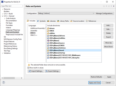

I'm using MCUXpresso IDE v11.0.0.
I have the following warning:
Invalid project path: Include path not found (\Project name\board). Location: pathentry Type: Path Entry Problem.
I checked in Properties->C/C++ General->Paths and symbols->GNU C and I have tthe following situation:
Could you please help me to remove the warning?

I'm really not sure what is going on.
Desperate try:
Otherwise: can you share your project?

The ones with the '/' at the beginning are all wrong: remove them.

have you checked the 'Path and Symbols' too?

In 'Path and Symbols' I have the following:

You need to use
"${ProjName}/board"
Remove the leading slash.

chobin
Dear Erich,
I wrote "${ProjName}/board", but the warning appears again.
I'm sorry, but I don't find the mistake.
