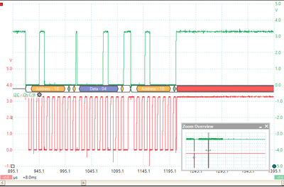

Alas!  Running the Figure (2) code yields an “arbitration” error, so it’s haul-out-the-oscilloscope time to see what’s going down on the SDA and SCL lines.  The results are shown in Figure (3):
            Figure 3.
Interesting…!  Cross referencing the Figure (2) code with the Figure (3) oscilloscope trace, the following is happening (even before the arbitration error:
  1. Fig (2) line 2 I2C start function call results in Fig. (3) as the first “Address -10”,
  2. Fig (2) line 6 write blocking function call  results in Fig. (3) as the “Data – 04” (that’s the 6030 read command).  All’s well so far….
  3. Fig (2) line 10 repeat start function call is shown in Fig (3) as the second “Address – 10”.  But…
  4. Note that the line 10 repeat start function call, which clearly includes the enumeration “kI2C_Read”, actually executes as a write (that is, bit0 is zero)!  From there on, the process collapses in chaos.
How can this be?

To summarize Fig 2 line 10 calls I2C_MasterRepeatedStart() with parameter 3, the direction, as read (i.e., 1).  Function I2C_MasterRepeatedStart() calls function I2C_MasterStart() with its’ parameter 3 also as read (i.e., 1).  In function I2C_MasterStart() the direction parameter is or-ed with the shifted I2C address and written to the MSTDAT register (figure 5 line 11).    By the time the data hits the bus (Figure 3) the read/write bit is cleared to a write.
Weird!
Can anyone see a failing in the logic here?
Thanks for your thoughts,
doug
