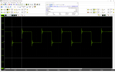

I'm replacing an older LPC-Link2 with the newer MCU-Link debug probe and I'm again trying to make use of the VCOM port. I could never get the LPC-Link2 to work at bitrates above 880kbps so I've never been able to make any use of it, but the MCU-link seems to behave properly at least up to 1.4Mbps, but above that it will no longer produce the correct bitrate.
I looked and couldn't find any newer firmware than the 1.098 which I'm using. Is the source code available for this (I assume it's based on the open DAPLink firmware)?
I have confirmed that the MCU-Link LPC55S69 UART itself (including the 74LVC1T45GW level shifter) runs fine well above the bitrate I'm trying to use (3Mbps), so this is a bug/misfeature somewhere in firmware-land. Note that it will happily accept a request for these bitrates, it just produces the wrong bitrate on the wire.
Any ideas how to proceed? It would _great_ to be able to retire the separate FT232H USB-to-UART adapter.

wj_ueos
Close enough to 3Mbps measured between pin 2 and 3 on the target UART header on the MCU-Link

wj_ueos
I did some more investigation that involved debugging the MCU-Link with another MCU-Link just to see what's going on. Turns out that Flexcomm0 USART is clocked from the slow 12MHz clock, which means that the 5-cycle minimum bit length will result in 2.4Mbps. Apparently there are some other issues with the baud rate calculation, but interestingly enough manually changing the clock source to the 96MHz source _automatically_ scaled every baud rate setting correctly, so there's a very simple patch against the 1.098 binary which will select the 96MHz source instead of the 12MHz.
Patching 0x7045f44f (mov.w r0, 0x314) at address 0x9918 (which gets RAM-loaded at 0x20009390) to 0x4014f240 (movw r0, 0x414) is all it takes. This will select clock source #3 (FRO 96MHz) instead of clock source #2 (FRO 12MHz) in register FCCLKSEL0.

radu_lazarescu
Hi @wj_ueos,
Yes, you're perfectly right. The Flexcomm0 used for VCOM is currently clocked from the 12MHz clock by the existing MCU-Link firmware. Additionally, a 9-cycle minimum bit length is enforced, which results in 1.33Mbps max achievable baudrate - matching your observations.
Anything higher than this requires FC0 to be clocked faster. FRO 96MHz is a good choice (divided by 2 in order to obey the 48MHz max Flexcomm clock).
If higher data rates are desired I can see no reason why we shouldn't include this change in a future MCU-Link firmware release. For the meantime your patch looks fine and allows a way forward to continue using MCU-Link.
