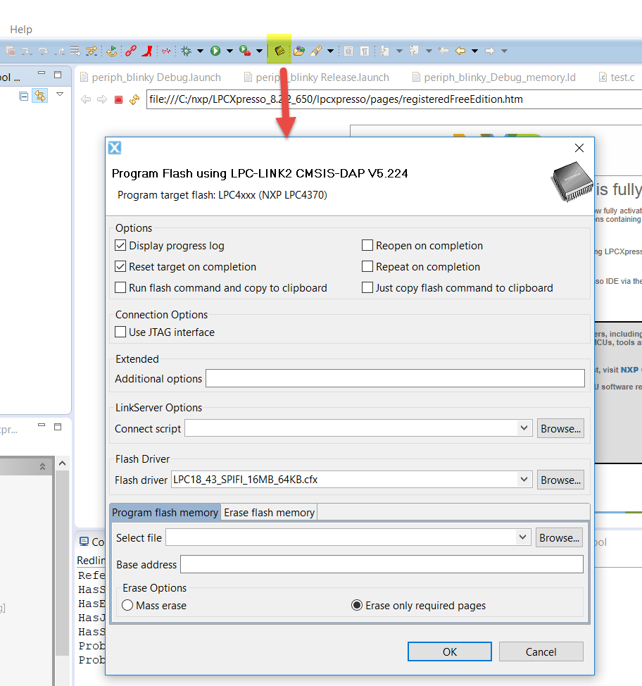

I am using LPCXpresso to develop and debug the application program running at LPC1769.
I can download the code to LPC1769 based PCB by using LPC - Link 2 and a customer inter-connection board and debug the code from the development environment (LPCXpresso).
Now, I need to know which software (not the development environment tool LPCXpresso) will be used to download the pre-build axf file into the product hardware (LPC1769 based PCB) by using LPC - Link 2 in the production line?
1,833件の閲覧回数
Hello Changwen Xie ,
Sorry as far as I know, there isn't a tool to download with LPC-link2 except IDE.
While there is a "GUI Flash Tool" inside LPCXpresso IDE, it can directly download file:
TIC
