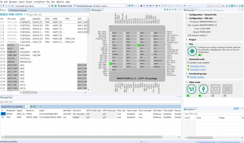

Unlike ST NXP does not seam to offer anything like CubeMX (or i haven't found it).
I did come across the MCUXpresso SDK Builder. I did select my MCU "MK64FN1M0VDC12" and selected "build"
However the "GCC Arm Embedded toolchain" fails to compile when i run the provided shell scripts (several CMAKE errors).

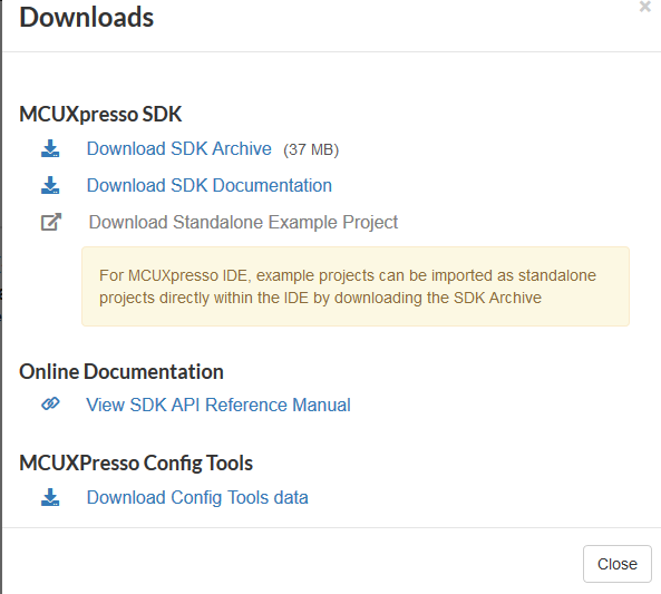

After failing the GCC Arm embedded toolchain i tried the MCUexpresso IDE version. What version do i have to select from this dialog?
The SDK Archive or the Config Tools Data?

Unfortunately we don’t have any c++ example. I suggest you to take a look at this link https://isocpp.org/wiki/faq/mixing-c-and-cpp for mixing C and C++.
On the other hand, the file you have to download is the SDK archive, please refer to this video to import an example https://www.nxp.com/video/mcuxpresso-ide-importing-sdk-example-project:MCUXPRESSO-IDE-IMPORTING-SDK-...
The config tool is an integrated suite of configurations tools that helps users with the development on arm processors.
Let me know if it helps.
