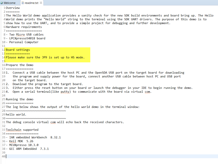

Hello henning larsen ,
Just want to make sure, have you set JP9 to HS mode as the readme.txt said:
TIC

larsen
Hello Alice Yang,
On LPC51018 IOTmodule which I use, there is no JP9. I think the readme.txt relates to another boards SDK (LPCXpresso51018) as it also states explicitly in the readme listed by you.
So the code originated from another devkit's SDK and the readme was not updated. I did however take the copy from the LPC51018 IOTmodule's SDK so it ought to work.
That said I doubt there is any reason it should _not_ work on IOTmodule because this has an onboard USB HS device (and no USB FS device) and the code is setup to use HS. Also, all the other examples relating to VCOM are working on IOTmodule, so there is proof of some code compatibility between the boards (assuming here that the LPCXpresso51018 board was the original host to test these programs.)
So as far as I can tell, it still points in the direction of a QC problem.
br henning
