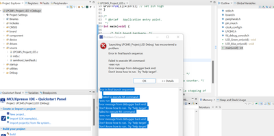

I am receiving this error when I try to run my program on MCUxpresso IDE with the LPC845-BRK board connected. Do you know how to solve it?

It could be many things, but: did you use the 'blue' debug button to start the debug session?
I hope this helps,
Erich

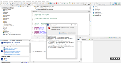

Facing this issue, could you please help me to solve this error.
I hope this helps,
Erich

tomato
I pressed the blue one and the debug session started correctly.
Thank you very much.

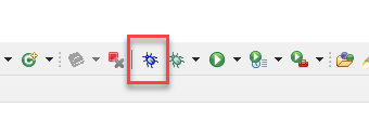

Can you give a glimpse of the difference between the green and the blue button debug? I have just started to learn how to use MCUxpresso

the blue one searches for available probes and creates the correct launch configuration.
Simply always use the blue one with MCUXpresso IDE.
You only can use the green one if you have a correct launch config already, and you want to select it manually.
