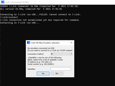

Hi Akihito, I hope you're doing well!
If the example programmed implemented Low Power mode, it's possible that the device is stuck in low power mode and needs to be woken up to be programmed.
Could you please try issuing an "unlock kinetis" command through the J-Link Commander software?:
Please let me know if you continue to have issues with your board.
Sebastian

I am also working with the FRDM-KW38 Board and I have the same problem. My board is in Low Power mode and I am not able to flash any other application onto it. I cannot connect to the device via J-Link Commander, so I am also not able to issue a  "unlock kinetis" command. How can I flash another Application onto my board? Thanks in advance!

Hello. I'm having the same problem. I uploaded the bluetooth_hrs_freertos example and now I'm not able to debug it again to upload a different code to the KW36 FRDM board. I cannot access also JLINK Commander since it cannot detect the USB Probe. I'm stuck. Please help on how to upload new code to the board.

I have the same problem here with the twr-km35z512VL. I was messing with the linker script and, after a flash, the JLinkExe detects the probe no more. It says: "No emulators connected via USB" even "lsusb" shows me the device "ID 0d28:0204 NXP ARM mbed".
