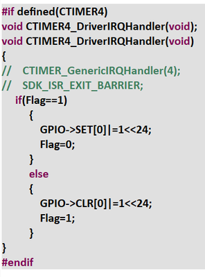

I was worked in the development Board of LPC804 Micro controller.Where I have a confusion regarding how much of timers can we used in the LPC804 Microcontroller.
Below I was attached the images of user manual of LPC804 where they mentioned the one General purpose timer.
Next image denoted that in software where they mentioned 5 Timer Handler function.So please kindly
clear my confusion?

Hi VIGNESH_BABU
LPC804 only has one 32bit CTIMER.
Where is your code from? Is that NXP SDK demo code?

VIGNESH_BABU
Yes SDK example code for Timer.
3,355 Views
ZhangJennie
Please send me the SDK version and demo full name. I will check,

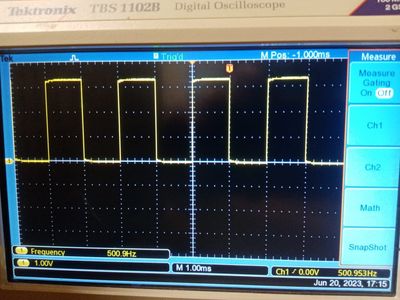

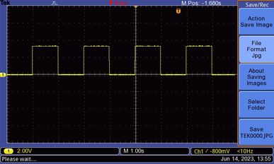

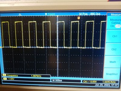

Here we attached the project file of SDK example of Timer in LPC804 Microcontroller.And I have one doubt regarding Timer.where I was unable to generate the time up-to 1 microsecond.Timer can generate up-to 300 microsecond.If I was gone above I was unable to get that time.Here I was attached the Images of DO(Digital Oscilloscope)
.Timer for 1 SecondTimer for 1 SecondTimer for 1 milisecondTimer for 1 milisecondTimer for 300 microsecondTimer for 300 microsecond

ZhangJennie
Please let me know your demo code package download link and path. SDK version.
I will test the orinial code. Thanks.
