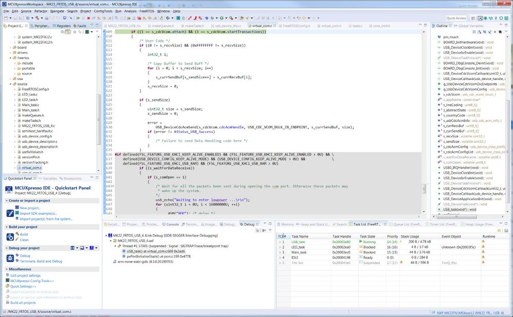

With the ending of support for Windows 7, I'm moving all my development to Linux and, for the most part, I'm pleased with how well MCUXpresso IDE works under Linux except for providing task debug information for FreeRTOS.  If I run my application under Windows, I get full debug information as you can see here:

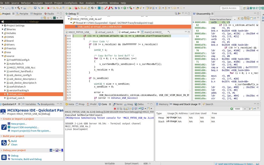

But I can't get any in Linux (I'm running under Ubuntu 18.04.4 LTS) - is it not set up or do I need to enable this capability?
These are the same projects running under the two different systems.
