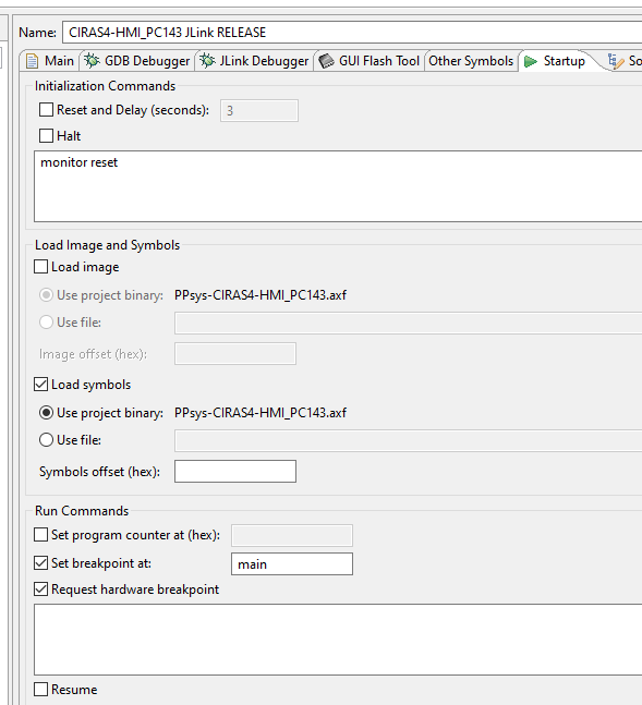

Hi All,
 How do I properly debug with MCUxpresso and a J-Link on a iMXRT1062 without flashing first?  I've unchecked "Load Image". But when I click Debug, and then Restart, I don't ever hit any breakpoint I set in startup_mimxrt1062.c's init code. My Jlink must not be syncing even though it's attached or something...?
1,549 Views
FelipeGarcia
Hello Mike,
I recommend you to check this blog from a colleague Attaching to a Running Target with Segger J-Link, GDB and Eclipse | MCU on Eclipse
I hope this helps!
