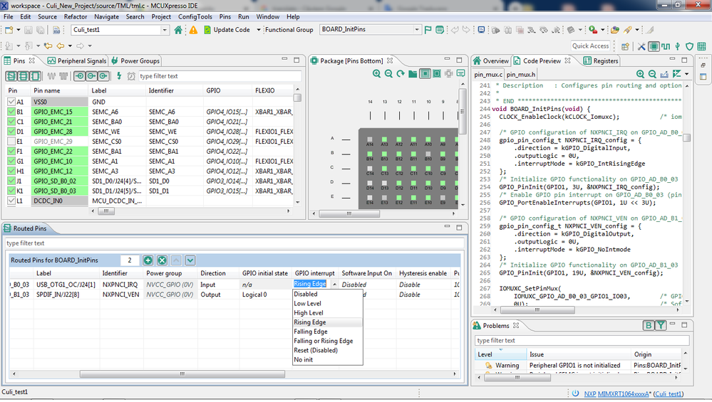

In the MCUXpresso IDE -> Config Tool-> Routed Pins -> GPIO interrupt, there are the following variants:
- Disabled
- Low Level
- High Level
- Rising Edge
- Falling Edge
- Falling or Rising Edge
- Reset (Disabled)
- No init
By setting one of the variants, for example "Rising Edge", the interrupt is implicitly enabled.
The way in which an interrupt is activated and the activation / deactivation of an interrupt are two distinct things and thus they must be treated separately in this configuration interface.
At program initialization, immediately after reset, the pins are fully configured but it is very possible to enable the interrupt to be made later in the program.
Thus the "GPIO interrupt" option needs to be replaced with two other options:
- "Interrupt Config": Low / Hi Level / Rising / Falling Edge.....
- "Interrupt Mask": Enable / Disable
This will give you natural flexibility in this case.

Hello Neculai,
Hope you are doing well. Could you please share the screenshot of the option you are referring to in the Configtools. I have attempted to follow as per your instructions but I do not get a drop down menu for the GPIO interrupt. Also could you please confirm the microcontroller you are using and if you are initializing with an example.

The microcontroller used is the iMX RT1064 using the MIMXRT1064-EVK board.
As you can see in the screenshot the pin named NXPNCI_IRQ has the property GPIO interrupt = "Rising Edge".
The code generated in this case as can be seen in the image is as follows:
/* GPIO configuration of NXPNCI_IRQ on GPIO_AD_B0_03 (pin G11) */
gpio_pin_config_t NXPNCI_IRQ_config = {
.direction = kGPIO_DigitalInput,
.outputLogic = 0U,
.interruptMode = kGPIO_IntRisingEdge
/* Initialize GPIO functionality on GPIO_AD_B0_03 (pin G11) */
GPIO_PinInit(GPIO1, 3U, &NXPNCI_IRQ_config);
/* Enable GPIO pin interrupt on GPIO_AD_B0_03 (pin G11) */
GPIO_PortEnableInterrupts(GPIO1, 1U << 3U);
A separate treatment of the two distinct properties is required, namely:
1. The way in which an interruption occurs refers to the registers; ICR1, ICR2 and EDGE_SEL
2. The masking of an interruption refers to the IMR register.
These two properties of a pin need to be set independently and this should be reflected in the generated code.
1. "Interrupt Config": Low / Hi Level / Rising / Falling Edge.....
generated code: GPIO_PinInit(GPIO1, 3U, &NXPNCI_IRQ_config);
2. "Interrupt Mask": Enable / Disable
generated code: GPIO_PortEnableInterrupts(GPIO1, 1U << 3U);  // for "Enable"
                                                                                                         // Clear mask bit for "Disable"
Neculai

Hi Neculai,
thank you for your feedback. The pin interrupt control interface in Pins tool for i.MX RT processor is actually reused from previous platforms (Kinetis, LPC) where the GPIO interrupt could be only either configured or disabled (i.e. there is only single bitfield / SDK function to set it up). However, you are right that this approach does not fully cover possibilities of GPIO on i.MX RT processors.
We will look on how to split the functionality for the i.MX RT GPIO interrupt settings in next version of MCUXpresso Config Tools.
