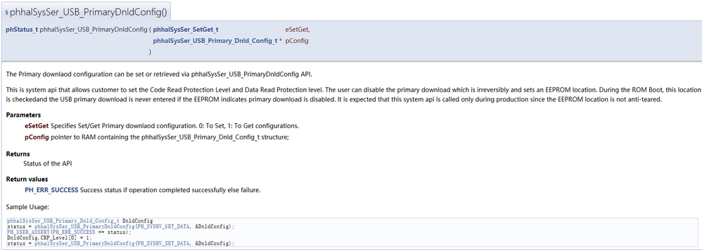

The "user_ee.bin" file has no relation with CRP level configuration, you should use phhalSysSer_USB_PrimaryDnldConfig(), just as I replied in the previous thread. This API would not brick the device, please feel free to use it according to the API user guide.
Kan

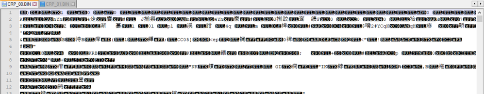

Did you power cycle the board after that?
Note: Securing the chip, disabling the SWD, shall NOT be done at every power up. This caused issues in the past. so if it is done once by receiving a command,  that would be fine, just avoid doing it e.g. at every power up.
BTW, if you use diff command to compare CRP_00.bin and CRP_01.bin, their contents are different.
and alternatively you may open these bin files by npp, and from the content view , you may find they are different , as the primary download just provides 0xff when CRP level is greater than 0.
Hope that helps,
Kan

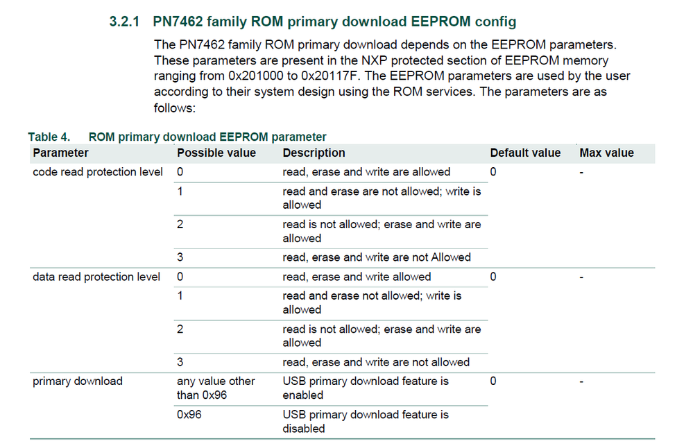

Kan_Li
Hi Manva,
Actually I did as the the UM10948 and got the same result as it is, please kindly refer to the following for details.
I think your issue might be due to the xml format, so I attach my file here, please refer to the attachment for details.
Actually xml file is just used to define your own parameters in the EEPROM, so you may lock your application just once. You know, we provide ROM system services for that purpose, but some API should be used considering EEPROM erase/write limitations.
Please refer to 3.3 in UM10913 for more details.
Hope that helps,
Kan

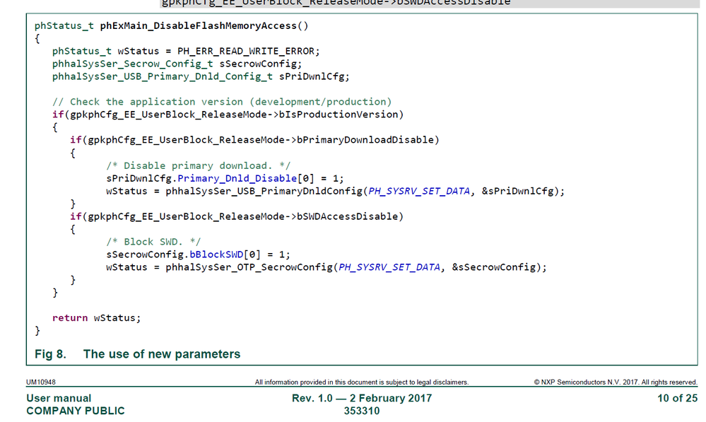

Kan_Li
Hi Manva,
Actually we have already provided a code snippet in UM10948 as below:
and if you want to protect the code and data from read, you should use the ROM system service:phhalSysSer_USB_PrimaryDnldConfig().because the following parameters locate in the NXP protected section. You can not use a xml file to get access to these parameters.
Prefer to the API guide, you may find the sample code as below:
Hope that helps,
Kan

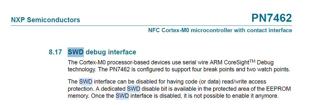

Kan_Li
Hi Manva,
You may disable the SWD interface to protect your application code. Please refer to the following for details.
Hope that helps,
Kan
