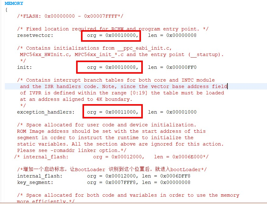

I've set the boot location to 0x10000, but why does codewarrior still erase 0-0xFFFF when I debug with codewarrior.How do I set up not to erase Flash's 0-0xffff because I put the Bootloader there.t.bmp
