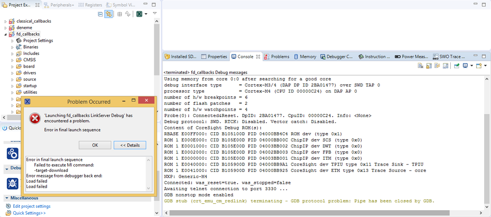

I am new for the MCUXpresso tool and LPCXpresso54618 card. To start with the card, I imported SDK example project (like 'hello world') and I have no problem.
Now, I am trying to import CAN-FD driver API example code. But when I import the example project and debug it, I got below error.
I simply want to activate 'classical_callbacks' example code. How can I do it ?
Thanks.

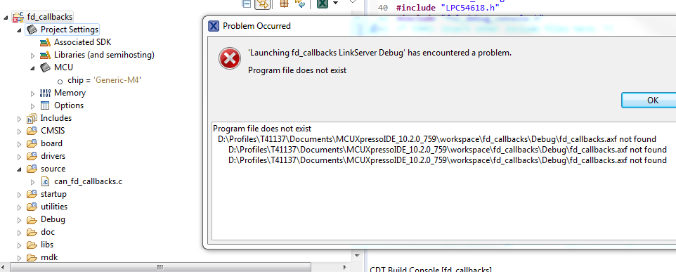

miguel_mendoza
Hi Anıl Onur Canbaz,
Change the size of the RAM is not a good practice when you are using an SDK, make sure that you associated the SDK to the project how I said in the past answer and check if effectively they were made. This should solve the issue.
Once you do the changes, you will notice in the memory details section, the type of memory, the location, and the size, you do not have to change anything, in plus if you have more than one project associated everyone with the SDK.
Wish it helps you!
Let me know if you can solve the problem.
regards,
Miguel Mendoza
4,212 Views
miguel_mendoza
HI Anıl Onur Canbaz,
The problem is caused because your project is not associated with the SDK of the MCU. To correct that you have to go to the properties of the project (ALT + Enter), C/C++ build >> MCU and there you have the SDK MCUs section, you have to select the "LPC54618J512" that is with your project work.
Once you salected, apply the changes and with that, you are going to be able to run the example.
Wish it helps you!
regards,
Miguel Mendoza.

canbazonur
Thanks Miguel,
After the building and debuging, I am getting below error. How can I solve the issue ?
Memory region Used Size Region Size %age Used
c:/nxp/mcuxpressoide_10.2.0_759/ide/tools/bin/../lib/gcc/arm-none-eabi/7.2.1/../../../../arm-none-eabi/bin/ld.exe: fd_callbacks.axf section `.text' will not fit in region `RamLoc'
c:/nxp/mcuxpressoide_10.2.0_759/ide/tools/bin/../lib/gcc/arm-none-eabi/7.2.1/../../../../arm-none-eabi/bin/ld.exe: region `RamLoc' overflowed by 3404 bytes
collect2.exe: error: ld returned 1 exit status
RamLoc: 19788 B 16 KB 120.78%
make: *** [fd_callbacks.axf] Error 1
21:38:20 Build Finished (took 2s.553ms)

canbazonur
I have just increased RAM limitation but now new problem occured:smileysad:
4,212 Views
