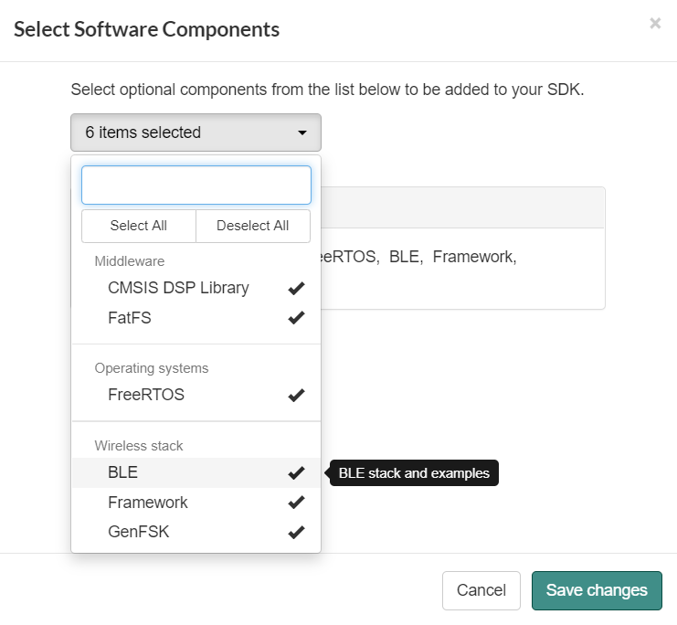

Hi Haider,
The KW36Z's SDK has a document called "Bluetooth Low Energy Host Stack API Reference Manual" that may be useful to get an idea of the structure of BLE applications, as well as the different functions and data structures of the API.
The document can be found in the following path:
<…\SDK_2.2.1_FRDM-KW36\docs\wireless\Bluetooth\Bluetooth Low Energy Host Stack API Reference Manual.pdf>
Also, the BLE API is included in the SDK archive if you selected the BLE stack middleware component when building the SDK in our builder.
You can also check the Bluetooth Developer's Guide, in the following SDK Path:
<…\SDK_2.2.1_FRDM-KW36\docs\wireless\Bluetooth\Bluetooth Low Energy Application Developer's Guide.pdf>
