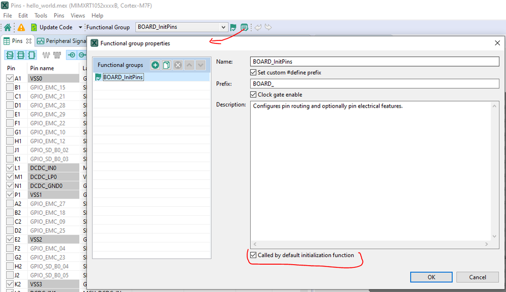

Is it possible to customize function name: BOARD_InitBootPins()?
I would like to have few hardware configuration in single projects and more than one name of such method will cause linker error.
3,856 Views
marek-trmac
Hi Grzegorz,
BOARD_InitBootPins() contains all configurations that should be executed after reset. You can add additional configuration called "Functional groups" using the toolbar and you can select for each, whether it will be invoked after reset or not.
For each functuional group, one C function is generated and its name is configurable.
BOARD_InitBootPins() name cannot be changed, the function is called from main.
Marek
