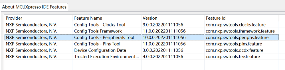

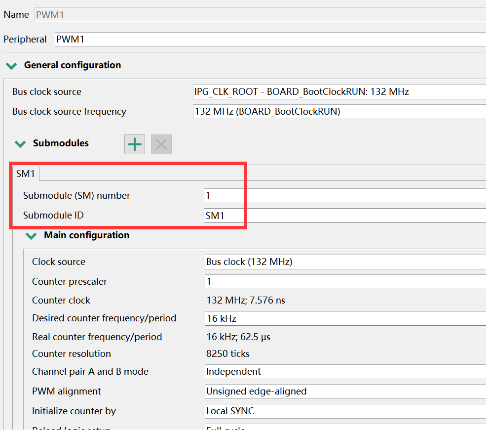

In my project, I use PWM1, submodule1, and Channel A for PWM signal output. but when I config interrupts, the Combobox cannot select the correct interrupt vector.
I am working with :
Windows 10
MCUXpresso IDE v11.5.1 [Build 7266] [2022-04-13]
SDK_2_11_1_EVKB-IMXRT1050
2,564 Views
jch
Hi @phantomgz, it is know issue and it was corrected in now available Config tools v12 which is present in MCUXpresso IDE v11.6.0: https://www.nxp.com/design/software/development-software/mcuxpresso-software-and-tools-:MCUXPRESSO
Please download it and enjoy.
