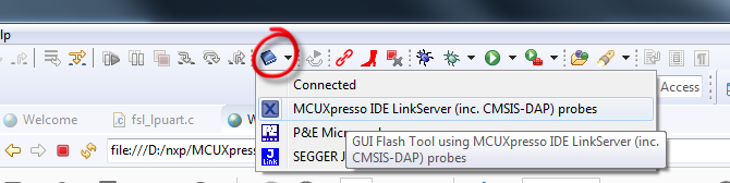

Dear sir/Mam,
Now, we are migrating our application(MK22FN512VLH12)  to "MCU Xpresso10.2 V".
  1. In MCU xpresso , how to  load   " .axf" file(without project)  using "GUI Flash TOOL"  ?
  2. which are  the NXP / Third Party Debugger ports support ?(P&E Micro or J Link) please suggest if any?
Dhanalakshmi s
3,890 Views
ZhangJennie
New in MCUXpresso IDE version 10.2.0, the rearchitected GUI Flash tool provides flash
programming capabilities for all supported debug solutions.
For detail, see {MCUXpresso IDE 10.2.0 install folder}/MCUXpresso_IDE_User_Guide.pdf,
Chapter 13. The GUI Flash Tool.

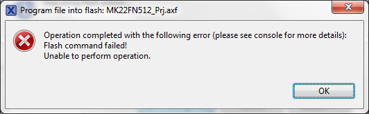

Dear sir,
Thank you for your reply.
  1. Without any sample project  " GUI Flash Tool" is disabled  in "MCU xpresso " Tool bar.
  2. So , We are created a New Sample project .
  3. In  "GUI Flash Tool" ,browse our ".axf" file using File System option in "GUI Flash Tool'.
  4.  P&E Micro used  to Load the ".axf" File into "MK22FN512VLH12" flash.
  5. But , It shows the Following error.
4.Please suggest me ,how to Load the ".axf" into  "MK22FN512VLH12" flash.
Dhanalakshmi S

ZhangJennie
I currently don't have K22 in hand. I tested K64 board with P&E OpenSDA interface.I didn't see any problem. See attached video
NOTE: Dummy project is necessary for using GUI Flash TOOL.
