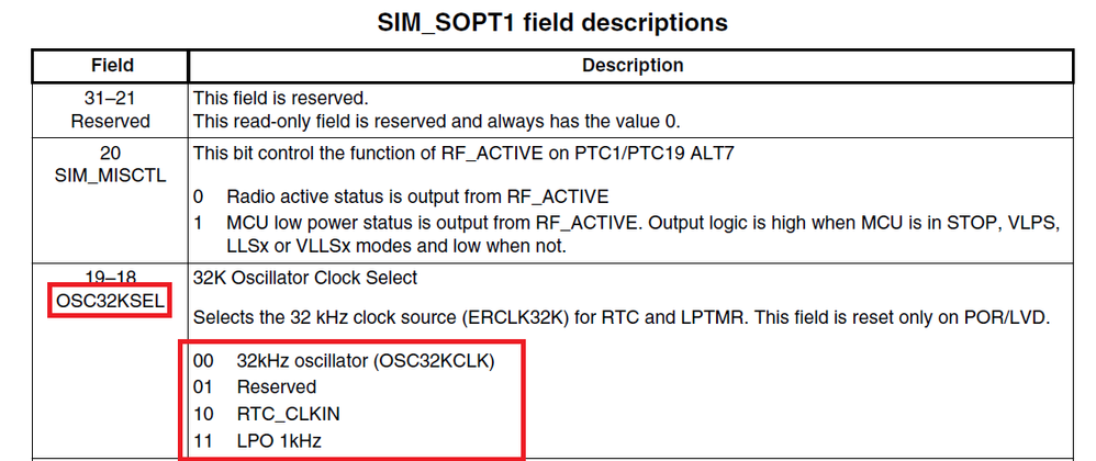

Hello Robrecht,
You can find description of clock selectors and other information in the reference manual, see for example the https://www.nxp.com/docs/en/reference-manual/MKW41Z512RM.pdf  reference manual.
The SIM clock selector values are described in the Chapter 11 System Integration Module (SIM), register definition:

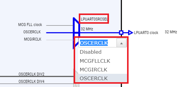

marek_neuzil
The comments of these definition contains the name of the clock selector and the selected value, see for example the SIM_LPUART_CLK_SEL_OSCERCLK_CLK definition. It is LPUART0SRCSEL clock selector (in the SIM device) that selects the OSCERCLK clock signal, see the following screenshot of the diagram:
Marek Neuzil

rdewaele
Hello Marek,
Thanks for responding to my question. However, your screenshot does not answer, but does further illustrate what my question is about. I encountered this screen and I noticed that the application knows what numbers correspond with what clock source.
However my question is, how can I know. Is the application the only source of this information? I suspect there are some technical specifications describing this? It just seems a bit weird that you'd need this application to figure out what bits correspond with what clock source.

marek_neuzil
Hello Robrecht,
