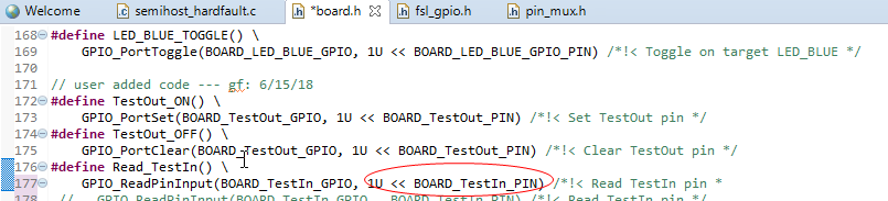

#define Read_TestIn() \
GPIO_ReadPinInput(BOARD_TestIn_GPIO, 1U << BOARD_TestIn_PIN) /*!< Read TestIn pin */

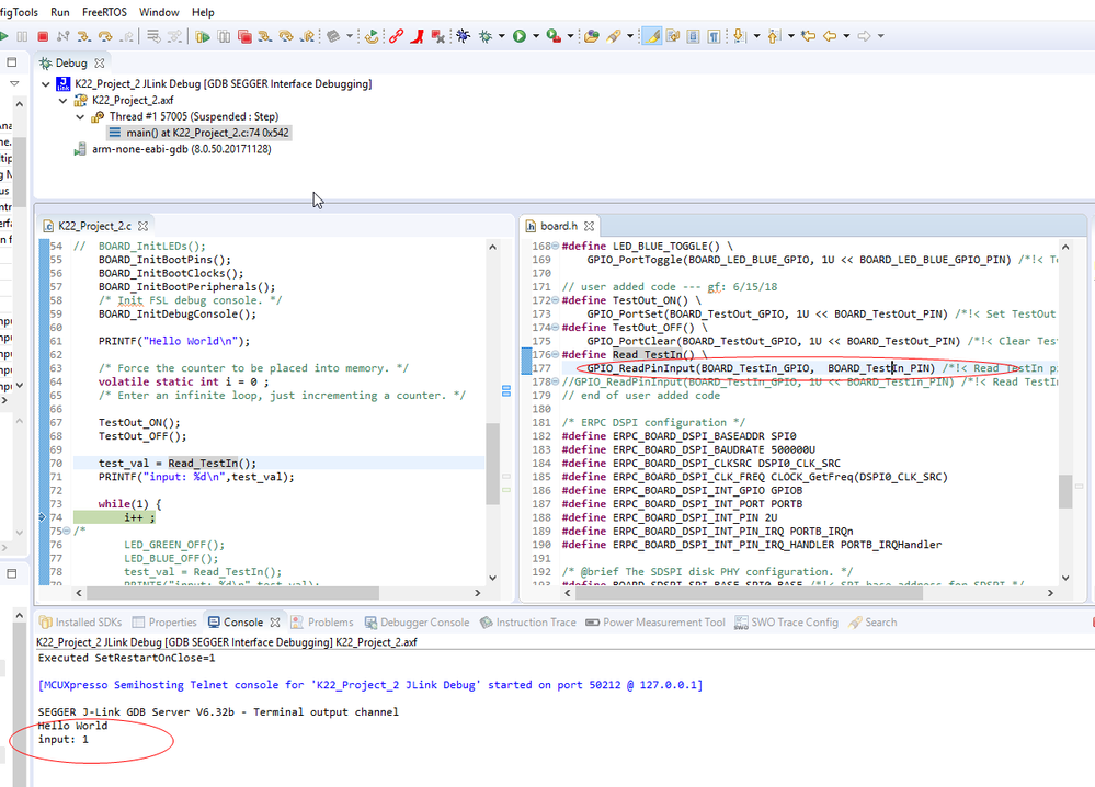

Hello Gang,
I have checked your code , I'm confused why does it left shift one bit at below:
If you change it to the below code , this meaning  read the PTA4 input pin :
 GPIO_ReadPinInput(BOARD_TestIn_GPIO,  BOARD_TestIn_PIN) /*!< Read TestIn pin */
the result is :

Hello Gang,
the result is :
