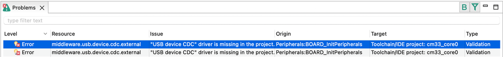

When creating a new project using ConfigTools for USB there is a problem with a missing resource and there is no way to add it:
Zrzut ekranu 2025-02-23 o 12.09.30.pngZrzut ekranu 2025-02-23 o 12.09.30.png
The problem appeared since SDK 24.12.00. MCUXpresso for macOS. Tested for LPC55s69, MCX A153 and MCX N947.

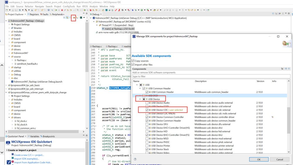

Hello @danielkrol
Please add the USB device CDC driver in the following way: Navigate to "Manage SDK Components", then select "USB middleware" and choose "USB CDC". The steps are shown as follows:

danielkrol
Perhaps this matters - the problem occurs in MCUXpresso on macOS (Apple Silicon).

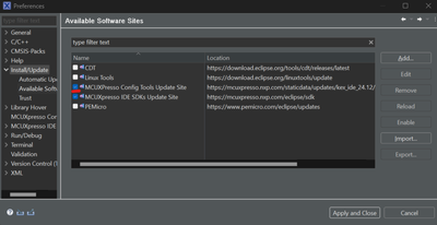

I'd like to share an update on this issue. I got a method from the MCUXpresso Config tool team, as shown below.
Please update Config Tools inside MCUXpresso IDE 24.12 to Config Tools 25.03:
  1. In MCUXpresso IDE, go to Help > Install New Software > Manage and enable the MCUXpresso Config Tools Update Site
2. Click Apply and Close and go to Help > Check for Updates. A new version of Config Tools will be available for installation. Finish the update using the update wizard.
Thank you.

danielkrol
I know about that - all drivers are added. Even projects created in older versions of SDK stopped working.
If I restore SDK 2.16.000 - everything works OK.
