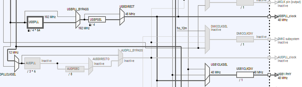

After using the clock config tool on OM13098 dev board (LPC546xx), I got the following values for USB PLL.
    /*!< Set up USB PLL */
    const usb_pll_setup_t usb_pllSetup = {
        .msel = 15U,
        .nsel = 0U,
        .psel = 0U,
        .direct = false,
        .bypass = false,
        .fbsel = false,
        .inputRate = 12000000U,
    CLOCK_SetUsbPLLFreq(&usb_pllSetup);                        /*!< Configure PLL to the desired value */
I expected these values to match the ones in CLOCK_EnableUsbhs0HostClock() in fsl_clock.c but they don't. Here are the values from CLOCK_EnableUsbhs0HostClock():
        usb_pll_setup_t pll_setup = { 0x3FU, 0x01U, 0x03U, false, false, false, 12000000U };
        CLOCK_SetUsbPLLFreq(&pll_setup);
Can I trust the values from the clock config tool? Is there a reason to use USB_N_DIV of 4 and USB_M_MULT of 64 in CLOCK_EnableUsbhs0HostClock()? Any advice would be greatly appreciated.

I noted the same discrepancy between the clock config tool and the source in fsl_clock.c.
Although both sets of figures may arrive at the same output clock frequency, the concern I have is that the settings in fsl_clock.c appear to set the USB PLL beyond the recommended MAX frequency in the datasheet.
So I'd like to know if it is safe to use the fsl_clock.c setting function, or do I have to implement my own copy using the values from the clock config tool?
3,928件の閲覧回数
rex_lam
Based on the formula Fout = M*(Fin/N)/(2*P), the USB PLL is not set beyond the recommended MAX frequency (using the values in fsl_clock.c). This is what it looks like in the clock tool.
So it should be safe to use fsl_clock.c functions.

Hi Rex Lam,
According the formula, Fout = M*(Fin/N)/(2*P), Fcco = M * (Fin/N) , when  usb_pll_setup_t pll_setup = { 0x3FU, 0x01U, 0x03U, false, false, false, 12000000U };,
it's easy to get USB clock = 64*(12 MHz/2)/(2*4)= 48 MHz.
About the structure usb_pllSetup that clock config tool generates, I can't jump to the conclusion that the structure is wrong before I can get more information, so I was wondering if you share the screenshot of the clock config tool.
TIC
3,928件の閲覧回数
rex_lam
Jeremy,
Thank you for your quick response. In usb_pll_setup_t, the second field is actually psel, and the third field nsel. Therefore, the formula is
64*(12 MHz/4)/(2*2) = 48 MHz
I have attached my clock diagram. I hope this is what you are asking for. I think the final frequencies are correct, but I would like to understand why it is different than the values used in fsl_clock.c.
