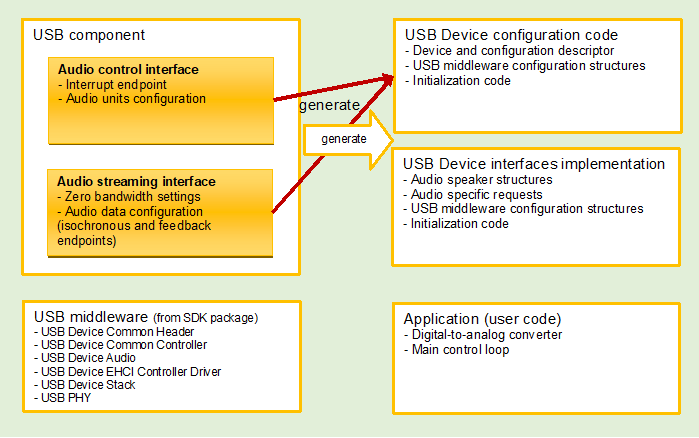

The USB Audio 1.0 speaker demo application that is described in this document consists of the following parts:
USB audio speaker application structure.pngUSB audio speaker application structure.png
Figure 1. Structure of the USB audio speaker application
The USB component supports the configuration of the Audio control interface and streaming interfaces for the Audio 1.0 class (see the MCUXpresso Config Tools Project chapter for the steps of creating the project with the USB component).

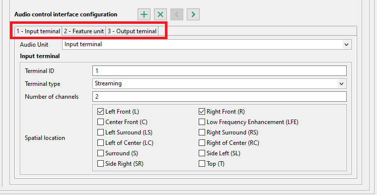

3.1.     Audio control Interface
The Audio control subclass provides a configuration of the USB Audio device topology by using terminals and units.
The USB component supports one interrupt endpoint (control endpoint) and the audio control interface settings (the topology). See the example of the Audio speaker configuration below.
Figure 2. Interface setting of the USB component
The USB component supports the following terminals and units of the Audio 1.0 specification:
  • Input Terminal
  • Feature Unit
  • Output Terminal
All these units are used in the Audio speaker example.
Input Terminal
The Input Terminal (IT) is used to interface between the audio function’s ‘outside world’ and other units in the audio function. It serves as a receptacle for audio information flowing into the audio function. Its function is to represent a source of incoming audio data after this data has been properly extracted from the original audio stream into separate logical channels that are embedded in this stream (the decoding process). The logical channels are grouped into an audio channel cluster and leave the Input Terminal through a single Output Pin.
The configuration of the input terminal consists of the ID (must be unique), type, number of channels, and spatial location, see below. The Input Terminal provides:

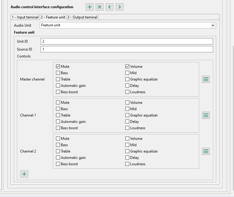

Feature Unit
The Feature Unit (FU) provides basic manipulation of multiple single-parameter on the incoming logical channels. It supports the following features: Mute, Volume, Tone Control, Graphic Equalizer, Automatic Gain Control, Delay, Bass Boost, and Loudness.
The configuration of the feature unit consists of the unit ID (must be unique), source unit/terminal, and selection of features for every channel.
Figure 4. Feature unit configuration

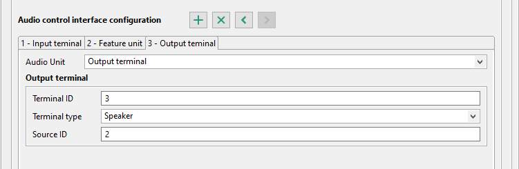

 Output Terminal
The Output Terminal (OT) is used to interface between the units inside the audio function and the ‘outside world’. It serves as an outlet for audio information, flowing out of the audio function. Its function is to represent a sink of outgoing audio data before this data is properly packed from the original separate logical channels into the outgoing audio stream (the encoding process). The audio channel cluster enters the Output Terminal through a single Input Pin.
The configuration of the output terminal consists of the ID (must be unique), type, and source ID (unit/terminal), see below.
Figure 5. Output terminal configuration

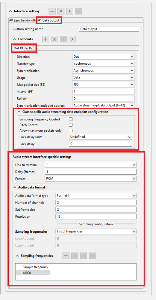

3.2.     Audio streaming interface
Audio Streaming (AS) interfaces are used to interchange digital audio data streams between the Host and the audio function. Each Audio Streaming interface can have at most one isochronous data endpoint and an optional associated isochronous sync endpoint for synchronization purposes. The isochronous data endpoint is required to be the first endpoint in the AS interface.
The AS interface is also used for the specification of the audio data format. The USB component Audio 1.0 class supports the Format I type of audio data only.
The configuration (in the Audio speaker example) does not provide any audio class-specific interface and endpoints. See the following configuration:
Figure 6. Zero bandwidth interface configuration
Data output alternative interface settings provide a full configuration of audio streaming class-specific settings including the audio data format. There are additional audio class-specific settings for isochronous endpoints.
Figure 7. Data output interface configuration

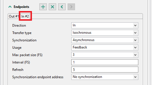

USB_audio_stream_1_data_output_feedback_ednpoint.pngUSB_audio_stream_1_data_output_feedback_ednpoint.png
Figure 8. Isochronous feedback endpoint configuration
The Audio speaker example uses two endpoints:
#1 – isochronous data endpoint (host output) for receiving audio data from the USB host.
#2 – isochronous feedback endpoint that is used for synchronization between the USB audio device and the USB host.
Audio stream interface-specific settings contain the Link to terminal setting which is linked to this audio streaming interface configuration and the audio data format configuration. The USB component supports just the Format I types. There is an additional configuration of the format – number of channels, subframe size, audio data resolution, and supported sampling frequencies.

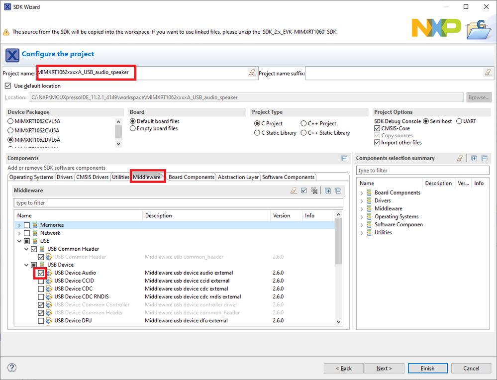

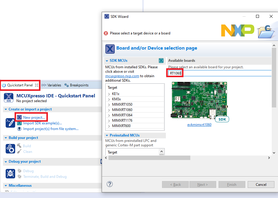

Open the MCUXpresso IDE. In the Quickstart Panel, select New project, in the SDK Wizard write RT1060 in the filter line, select the evkmimxrt1060 board, click the Next button.
Figure 9. New EVKMIMXRT1060 project
In the next window, write the project name, for example, MIMXRT1062xxxxA_     and select the USB Device Audio class on the Middleware tab (all the required components of the USB middleware are automatically selected), see below:
Figure 10. USB middleware components of the new project
Click the Finish button (the default libraries, compiler, linker, and memory map settings can be used).
The MIMXRT1062xxxxA_USB_audio_speaker project is created in the IDE. The content is available in the Project Explorer window.

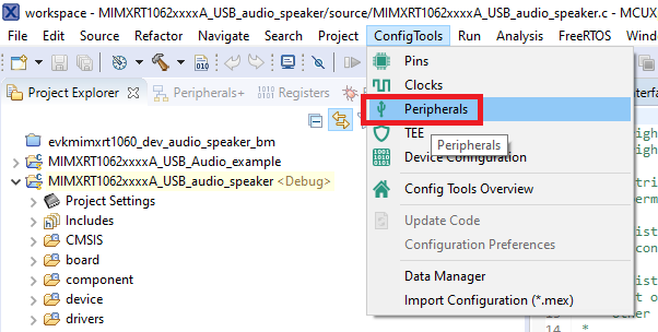

4.2.     Peripherals
Open the Peripherals tool by using the Config Tools -> Peripherals.
Figure 11. Selection of the Peripherals tool

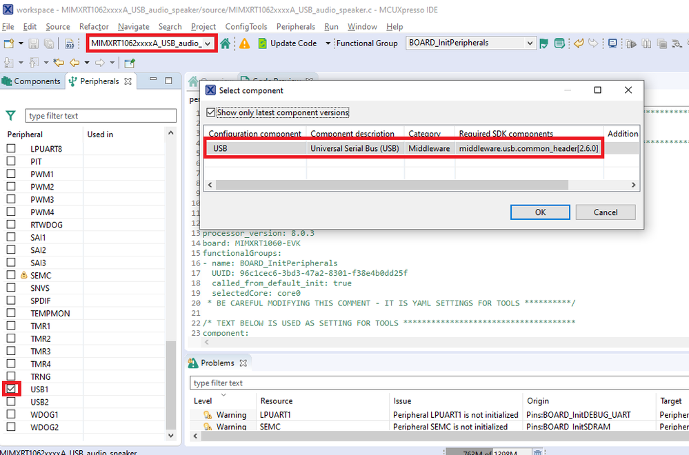

In the Peripherals tool, select the MIMXRT1062xxxxA_USB_audio_speaker project and create an instance of the USB 2.6.0 (or newer version) component for the USB1 peripheral in the Peripherals window, see below:
Figure 12. Adding of the USB component

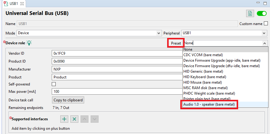

The USB component is added to the Peripherals project (in the default functional group that is named BOARD_InitPeripherals). An empty USB component is created (there is no interface created and the USB component reports errors). The easiest way to create a functional USB configuration is by selecting from a preset. Select the Audio 1.0 – speaker (bare metal) preset.
Figure 13. Selection of the Audio 1.0 speaker demo project configuration
When you select the Audio 1.0 – speaker (bare metal) item, the whole configuration of the example is configured. Two interfaces are created:
#0 – Audio_control
#1 – Audio_streaming
These interfaces contain all settings that are required for the USB Audio 1.0 speaker example. configuration of all audio units is provided in the Audio_control interface. The Device role configuration is also provided for the USB Audio demo example. See details of the provided settings in the previous chapter USB Audio concept.

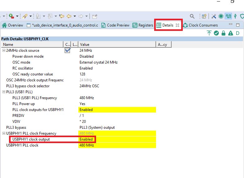

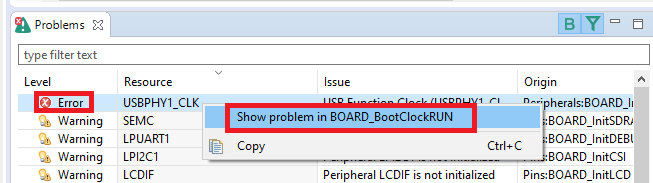

There is still the following error in the Problem view:
Issue: USB Function Clock (USBPHY1_CLK) is inactive and USB module will not work.
Level: Error
Type: Validation
Tool: Clocks
Origin: Peripherals:BOARD_InitPeripherals
Target: Clocks: BOARD_BootClockRUN
Resource: USBPHY1_CLK
Figure 14. USB clock source error
Right-click the error and select Show problem in BOARD_BootClockRun.
Figure 15. Resolving of the USB clock source error
The Clocks tool is opened, and you are navigated to the problem in the Details view. The USBPHY1 PLL clock is disabled by default (to save power). You can enable it by selecting the enabled value in the USBPHY1 clock output setting:
Figure 16. Enabling of the USB clock source in the Clocks tool
This setting enables the 480 MHz reference clock for USBPHY1 and the USB peripheral runs.
Go back to the Peripherals tool. You can see that the error was resolved, and the code is generated.

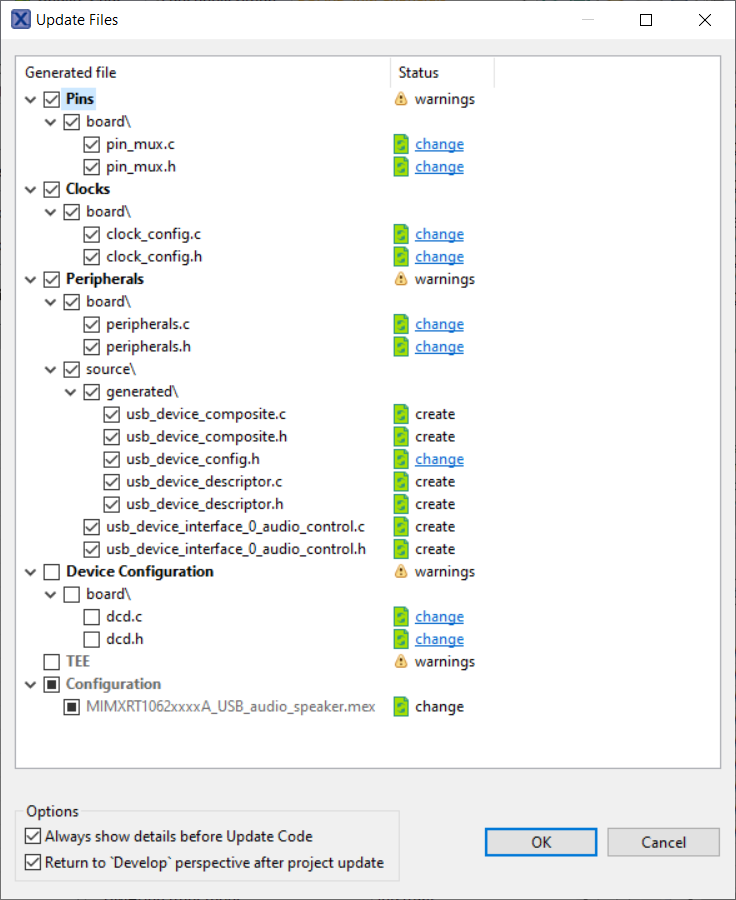

If you click the Update Code button, you can see what code is provided by the Config Tools. There are the following functions.
Pins initialization functions:
  • pin_mux.c/h – initialization of the routed pins for the peripherals (USB1, TMR3 in our use case).
Clocks initialization functions:
  • clock_config.c/h – initialization function for a configuration of the clock source, selectors, dividers, PLLs, and other system clock settings of the MCU.  A configuration of the USB1 clocks for PHY that was enabled is also provided.
Peripherals initialization functions and the USB code example:
  • peripherals.c/h  initialization functions for configured peripherals (USB1, TMR3 components).
  • usb_device_composite.c/h contains initialized structures, initialization functions, device callback function, interrupt routine, and other USB middleware-related functions.
  • usb_device_config.h contains USB middleware configurations (definitions) that are directly included in the USB middleware.
  • usb_device_descriptor.c/hcontains definitions of the device descriptor, device configuration descriptor, initialized interface and endpoints configuration structures, function for device speed selection, and other USB device-related functions.
  • usb_device_interface_0_audio_control.c/h contains the generated code example of the audio speaker. There is an application code for processing USB device requests, processing audio data, and configuration structure of the audio speaker example (buffer, runtime settings, …).
When any of these generated files are customized (modified in the project), uncheck the file in the Update Code dialog. Otherwise, the changes would be lost.
Figure 17. Update of the generated code in MCUXpresso IDE project

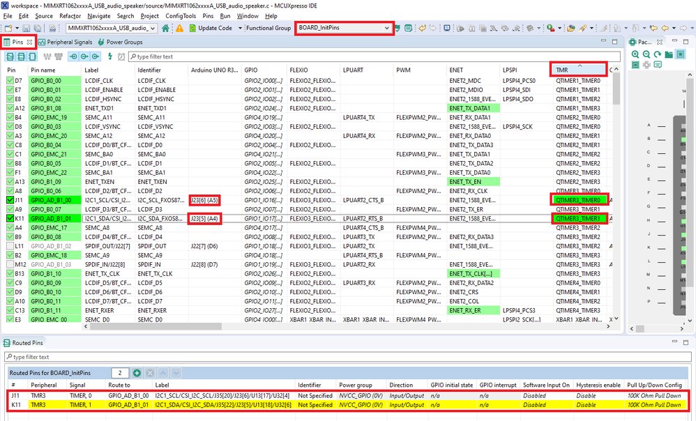

You can create a simple DAC converter by using a timer of the MCU.  Select. The board provides Arduino headers that can be used for this demo purpose. The J23 header provides an output of the TMR3 – channels 0 and 1 (J23[6] and J23[5] pins). You can find this information in the Pins tool.
Open the Pins tool and navigate to the Pins window. Select the BOARD_InitPins functional group (it is selected by default, and it is also included in the default initialization).To order the table lines according to the TMR peripherals, click the TMR column header. You can see that QTIMER3 (TMR3) timers #0 and #1 can be routed on Arduino header J23. When you click QTIMER3_TIMER0 and QTIMER3_TIMER1 in the TMR column, these timer outputs are routed automatically to the J23[6] and J23[5] pins on the Arduino header on the board.
Figure 18. Routing of the timer pins in the Pins tool

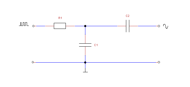

The PWM output signal can be processed through a low-pass filter (R1, C1) with an output filter capacitor (C2) to remove some of the DC from the signal.
Figure 20. Low-pass output filter
fc=1/(2πRC)
For example, use the following low pass filter:
R1= 4700 Ω, C1 = 1.5 nF
fc = 22575 Hz

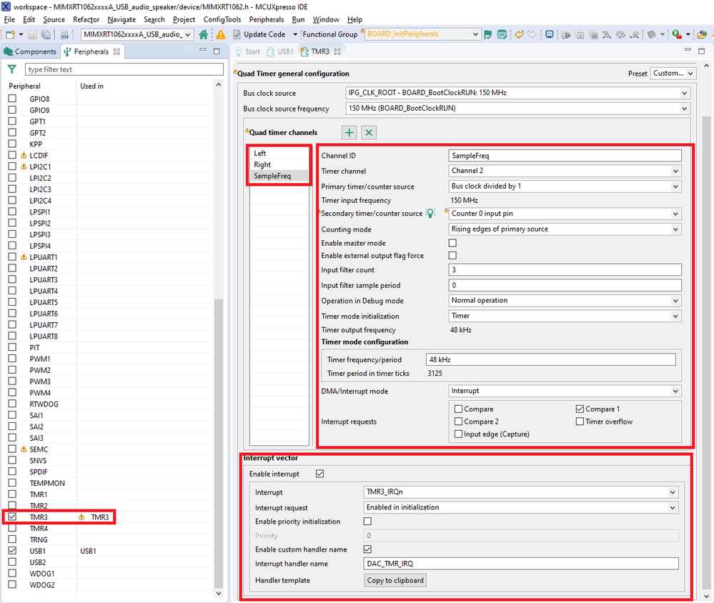

Third channel for invoking the interrupt routine at sample frequency:
Chanel ID: SampleFreq
Primary timer/counter reference: Bus clock divided by 1
Counting operation: Rising edge of the primary source
Timer mode initialization: Timer
PWM frequency/period: 48 kHz
DMA/Interrupt mode: Interrupt
Interrupt request: enable Compare 1

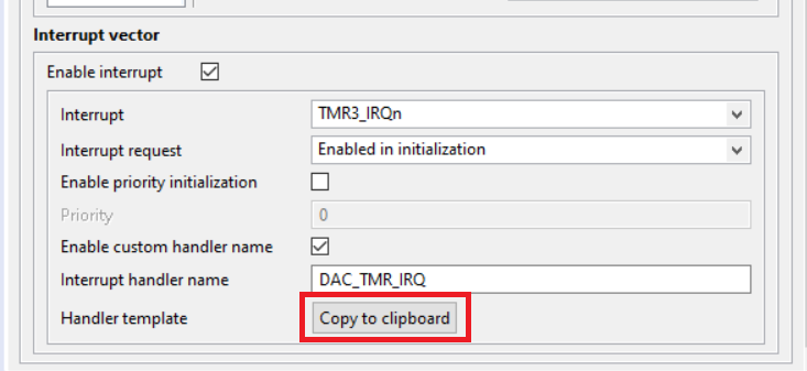

Interrupt vector
Enable interrupt: enabled (checked)
Enable custom handle name: enabled (checked)
Interrupt handler name: DAC_TMR_IRQ
Note: The interrupt of the SampleFreq channel is only used to load the compare load registers of both channels at the sampling frequency. The Digital-to-Analog conversion of both channels is synchronized and one simple interrupt routine can be used.
 The Quad Timer components provide initialization but you must provide runtime functionality. Therefore, you must know the details of the PWM mode functionality (specified in the reference manual of the MCU). The PWM mode with variable frequency is driven by both compare registers. The second compare register provides a high-level period of the PWM period (duty), and the first compare register specifies the inactive part of the PWM period. The sum of these two compare registers must always be the computed resolution of the timer (625). An example of the initialization of compare registers can be found in the fsl_qtmr SDK driver, in the QTMR_SetupPwm() function.Compare registers are initialized before the counter/timer is started. The next values can be stored by using compare load registers. Thus, the loading of the compare registers is synchronized automatically by the timer itself (it is a part of the initialization setting in the fsl_qtmr driver).
Therefore, the interrupt routine can be used for loading the audio data into compare load registers.

Finally, configure the TMR3 peripheral in the following way:
Figure 21. Quad timer configuration for the DAC

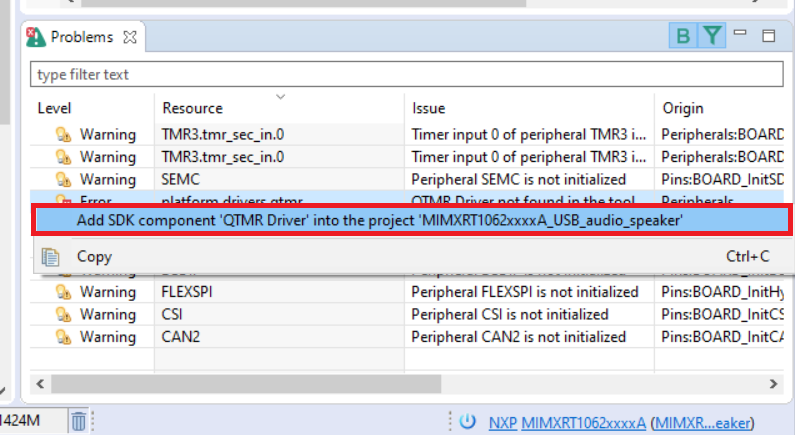

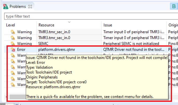

In the Problems view, an error is reported. The error is caused by the missing fsl_qtmr SDK driver in the project (it was not added in the project wizard of the MCUXpresso IDE).
Figure 22. Quad timer SDK driver error
To fix the error, use the context menu of the error in the Problems view and select the Add SDK component “QTMR Driver” into the project “MIMXRT1062xxxA_USB_audio_speaker.
Figure 23. Adding of the Quad timer SDK driver in the MCUXPresso project.
When the option is selected, the update of the files is processed and the error disappears. The initialization of the application is done, and the generated code can be used in the project.

4.4.     Audio application design
The USB Audio code example has been generated into the project and it works. But the playback of the audio data is not provided. Only the USB_Interface0AudioControlProcessNextAudioData() function is available in the source/usb_device_interface_0_audio_control.c source file. The received audio data is available in the internal USB_Interface0AudioControlDataBuff buffer and the index () of the newly received data is s_UsbDeviceAudioSpeaker->tdWriteNumberPlay. It is used to send data into the DAC converter.The DAC converter has not been implemented yet. There are just two PWM channels of the TMR3 that generate a zero-duty PWM output signal. Use the interrupt subroutine for the implementation of the audio playback. Copy the template of the interrupt routine from the TMR3 component in the Peripherals tool, see the Interrupt settings:
Figure 25. Template of the interrupt service routine.
When you click the Copy to clipboard button of the Handler template setting, you obtain the following code in the clipboard.
/* TMR3_IRQn interrupt handler */
void DAC_TMR_IRQ(void) {

4.4.2.   DAC interrupt routine
The interrupt routine of the TMR3 peripheral provides the functionality of the DAC converter. It processes a stream of audio data packets and uses the sample values to control the duty of the output PWM signal (the first PWM channel as the left channel and the second PWM channel as the right channel). The sampling frequency is driven by the third channel of the TMR3 (the SampleFreq channel). See the implementation of the interrupt routine and related definitions:

The audio data is loaded (the pointer to audio data buffer is used) using the USB_Interface0AudioControlProcessNextAudioData() function. The whole packet of audio data is always provided (the PCM_PACKET_SIZE definition).
When any audio data is available, the sample data is used to control the PWM duty of the left and right channels. The audio data is in the int16_t format, but the compare load register needs a 9-bit unsigned integer value. Therefore, these sample values are converted by the expression (see the source code above).
