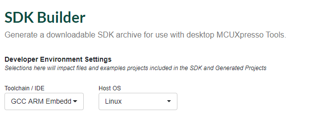

Step 1: SDK Builder, selected GCC ARM Toolchain and Host OS: Linux
Step 2: Downloaded: SDK_2.8.0_EVK-MCIMX7ULP.tar.gz and extracted archive.

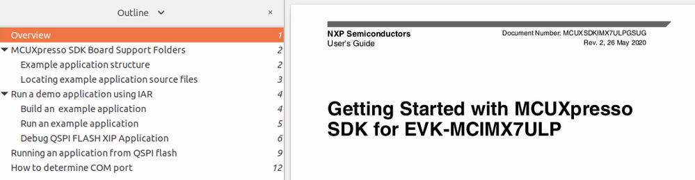

Opening 'Getting Started with MCUXpresso SDK for EVK-MCIMX7ULP.pdf'
Previous SDK releases provided chapter for using ARM GCC on Linux OS Host, where are the instructions for SDK 2.8.0?
SDK 2.7.0 does have missing sections.
SDK 2.6.0 Getting Started outline showing Arm GCC and Linux host are shown:

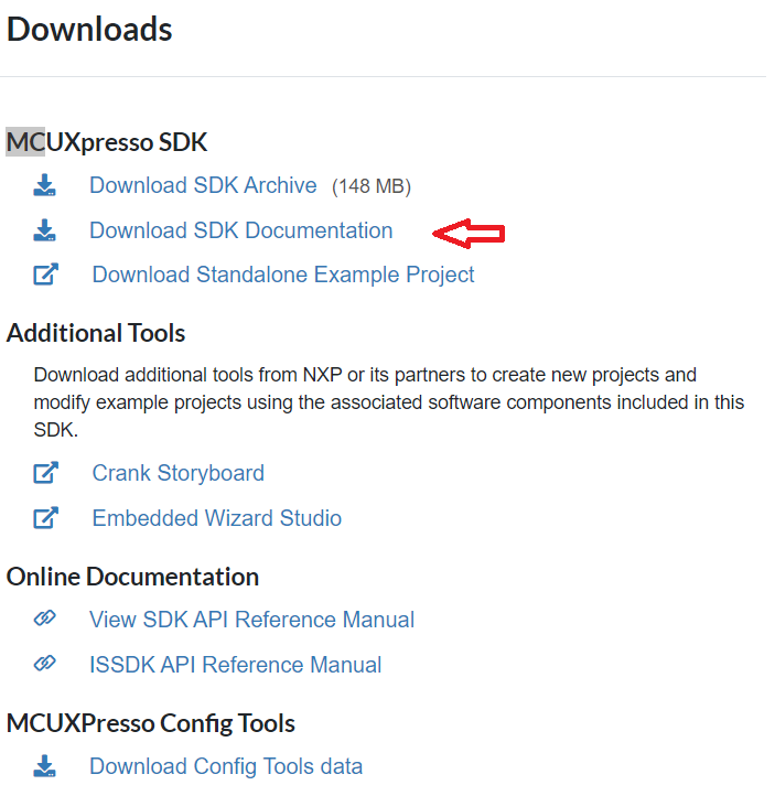

Hi Curtis:
You can download latest SDK documentation from here, Welcome | MCUXpresso SDK Builder , as below picture shows.
9,032 Views
CurtisWald
Hi Daniel,
Followed your instruction to download SDK Documentation and this also has the defect of no instructions for running on Linux host and setting up the Arm tool chain.
Both the "Download SDK Archive" and "Download SDK Documentation" fail to provide the Linux steps.
Attached is the "Getting Started with MCUXpresso SDK for EVK-MCIMX7ULP.pdf", that only has section "Run a demo application using IAR", which is Windows host only.
Where are the Linux host and tool chain getting started steps?
