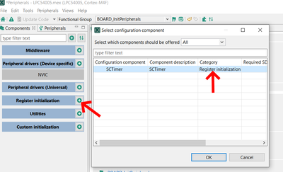

I'm not sure where is the problem in this case, however, could you write more about your goal with SCTimer?
If it's more than just very simple PWM, I recommend to use the SCTimer register init component that allows to leverage all capabilities of the hardware and it's not dependent on SDK driver.
To add this component you can use the Components view and clock on the '+' button at Register initialization category:
Best regarts
Petr Hradsky
