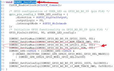

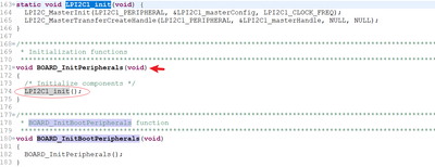

Hi @JackNXP ,
Could you please tell me of the versions of the MCUXPresso IDE and SDK lib.
Which SDK example or operation are you referring to?
InitBootPins() is the default pin_mux initialization entry point generated by the config tool, while InitPins() represents the specific operations generated by the config tool based on the configuration.
I did a test for your question.
IDE:  MCUXPresso IDE 25.06
SDK: SDK_2.x_EVK-MIMXRT1064 25.06
When I add an LPI2C1 peripheral by using the Peripherals Tool, the I2C pin initialization is performed by BOARD_InitPins() instead of BOARD_InitBootPeripherals().
Wish it helps you.
