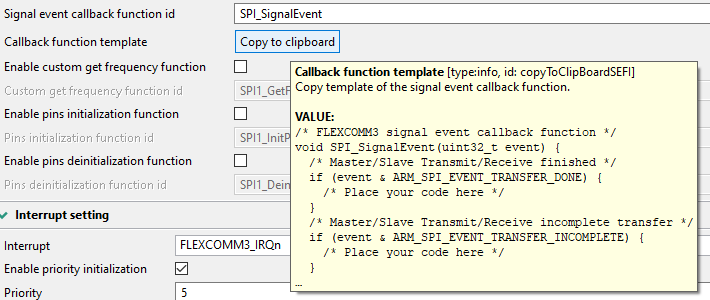

I think I found another "WTF?":
For the SPI driver, Peripherals Tool provides a callback function template:
Select a Flexcomm instance and click on "Copy to clipboard".
This is what you'll get:
/* FLEXCOMM3 signal event callback function */
void SPI_SignalEvent(uint32_t event) {
  /* Master/Slave Transmit/Receive finished */
  if (event & ARM_SPI_EVENT_TRANSFER_DONE) {
    /* Place your code here */
  /* Master/Slave Transmit/Receive incomplete transfer */
  if (event & ARM_SPI_EVENT_TRANSFER_INCOMPLETE) {
  /* Address not acknowledged from Slave */
  if (event & ARM_SPI_EVENT_ADDRESS_NACK) {
  /* Master lost arbitration */
  if (event & ARM_SPI_EVENT_ARBITRATION_LOST) {
However, this does not compile as none of the "event macros" is defined.
The file Driver_SPI.h defines only:
/****** SPI Event *****/
#define ARM_SPI_EVENT_TRANSFER_COMPLETE (1UL << 0)  ///< Data Transfer completed
#define ARM_SPI_EVENT_DATA_LOST         (1UL << 1)  ///< Data lost: Receive overflow / Transmit underflow
#define ARM_SPI_EVENT_MODE_FAULT        (1UL << 2)  ///< Master Mode Fault (SS deactivated when Master)
These are the "official" SPI event macros as specified in the ARM template driver.
NXP, please fix this.
Thanks.

This issue seems to have been fixed.
I tested it with MCUXpresso IDE v11.7.0, the Peripherals Tool that came with it (version: 10.0.0.202301120728) and SDK_2.x_LPC5526 (v2.13.0).
在原帖中查看解决方案

Hi Daniel,
Thank you for reporting this issue.
The SPI CMSIS driver component will be fixed in the nearest data update for the MCUXpresso configuration tools version 11.
Jan Kucera.

That's what the code should look like:
  /* Master/Slave Transmit/Receive success */
  if (event & ARM_SPI_EVENT_TRANSFER_COMPLETE) {
  /* Master/Slave Transmit/Receive transfer failed */
  if (event & ARM_SPI_EVENT_DATA_LOST) {
  /*  ARM_SPI_EVENT_MODE_FAULT
   * is not supported by SDK CMSIS driver implementation
   * see s_SPIDriverCapabilities in fsl_spi_cmsis.c */
I wonder whether I'm the first one to complain about this. Is nobody else using Peripherals Tool?
