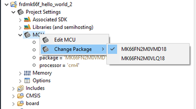

Hello ,
we evaluatet the HVP-MC3PH.
Now we have build our own hardware.
We want to use the MKV32F256 in the 64pin package.
In the config tool we have the 100 pin package.
In the documentation is written, you can switch the processor with file->switch processor.
But the menu has no such entry.
What do we wrong?
MCUXpresso IDE v11.3.1 [Build 5262] [2021-04-02]
SDK is up to date.
SDK_2.9.0_MKV31F256xxx12
Andreas
2,757 Views
liborukropec
Hello Andreas,
the switch processor menu is accessible in the stand-alone version of the Config Tools. When integrated with MCUXpresso IDE, the package must be switched in the CDT project settings:
(screenshot contains different processor, but the principle is the same)
Config Tools should detect this and switch also its configuration. If not immediately, then during the next opening of the configuration.
