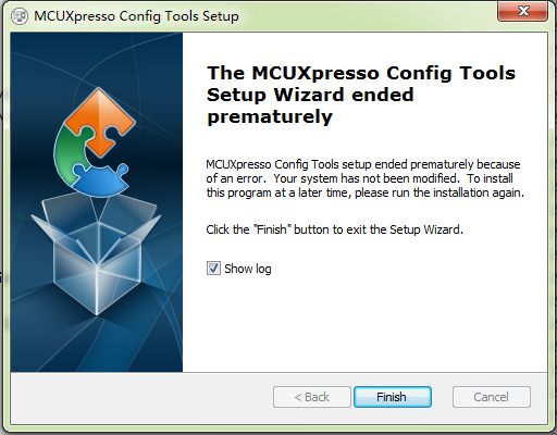

When installing by executing MCUXpresso_Config_Tools_v3_x86.exe, a dialog appears to indicate installation failure:
Attached log files it shows to me.
Environment: WIndows 7 32bit.
Installation file downloaded from this web page:
http://www.nxp.com/products/software-and-tools/run-time-software/mcuxpresso-software-and-tools/mcuxp...
Thanks.
Original Attachment has been moved to: MSIBDE7.LOG.zip

This failure is most often caused by the lack of or corrupted registration of the Microsoft OLE Automation library OLEAUT32.DLL.
You should confirm that this file is installed on your target system, and that is is correctly registered using regsvr32.exe.
Microsoft updated this file in Patch MS07-43 (KB921503) and MS08-08(KB943055). Since these are both important security updates, you should have both of them already installed. This file should be a protected system file, and any attempt to unregister it will return an access violation. However, it's registry signature could also be corrupted.
Microsoft provided solution as a part of Hotfix in May 2015: https://support.microsoft.com/en-us/kb/3020338

Hi Martin,
Thank for reply.
This dll oleaut32.dll is in /Windows/System32.
I tried to run "regsvr32 oleaut32.dll" under cmd prompt and it shows that already succesfully registered by DllRegisterServer.
However I did not find KB921503 and KB943005 in the list of installed hundreds of security updates, also did not find them in Windows Update. Maybe it already included in Windows 7 SP1?
At last, I went to the link in your reply, downloaded the patch Windows6.1-KB3020338-x86.msu as instruction, and run it, but was told this patch is not applicable to your system...
Any other hints? Or do I need to re-install any supporting package?

1. Could you please try to register all the folllowing DLL files from administrator Command Prompt:
regsvr32.exe vbscript.dll
regsvr32.exe oleaut32.dll
regsvr32.exe jscript.dll
regsvr32.exe msxml3.dll
regsvr32.exe -i shell32.dll‍‍‍‍‍
please restart the machine and check if problem still persist.
2. You can also try to register the windows install service
C:\Windows\System32\msiexec.exe /regserver‍
3. There is also some chance, that scripts run by installer might be blocked by antivirus program. Please try to disable it before installation.
4. If issue still persist, could you please send me your oleaut32.dll file? I will try to reproduce the issue on our machine.

Hi Martin,
Unfortunately issue is still there after doing suggestion 1 and 2.
I have no anti-virus software installed because this is a quite pure environment only for developing.
By the way, my win7 is running in virtual machine VMWare player, not sure if this impacts. But, all other programs installation and running is good, like Codewarrior, KDS, IAR bench, etc, and the previous Processor Expert Pin Tools also runs well.
Attached the oleaut32.dll, FYI.
