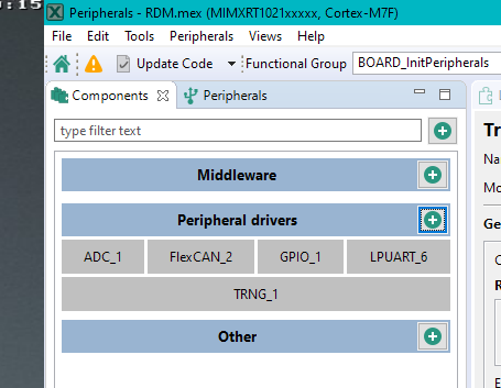

I'm setting up a project with a IMXRT2021. After configuring the pins, I tried to configure the peripherals. Some (e.g. ADC1) work fine, but whenever I click on LPI2C1 or LPSPI1 I get a java.lang.NullPointerException and no code is created for these peripherals.
Does anyone else have the same problem? I know that FLEXSPI is not supported by v6 but LPI2C and LPSPI were listed.

Hi Aron,
I have looked to your MDK project and it seems the problem is related to empty include path - such configuration is not typical and it is not handler in Config Tools properly. We'll fix this for next update.
As a workaround, specify include path in MDK.

marek-trmac
Hi Aron,
Config Tools were updated and the issue was fixed. You can download 6.0.1 update.

aron_mueller
Hi Lukas,
As a matter of fact, I cannot select the component. There is no pop-up:
Only if I click on the "+" sign of "Other", I will see a pop-up (with no paripherals available in this case).
I attached the LOG.
Aron

aron_mueller
Hi Marek,
I've attached the root folder.
Just for testing, I created a new MCUXpresso project that is not attached to the toolchain and set up the peripherals before the pins. There I have no problem. In the worst case, I could use that new project. But how would I attach a toolchain now?
Aron
6,843件の閲覧回数
marek-trmac
Hi Aron,
In MCUXpresso IDE it is easier. The Config Tools are directly integrated in the IDE and take SDK components used in the project directly from API.
You can also used Config Tools separated from the MDK project. Just save MEX file outside MDK project root and it will work similar. There will be limitation that the Config Tools will not have any information about SDK components used in the project, so will not advise what's recommended for you configuration.
