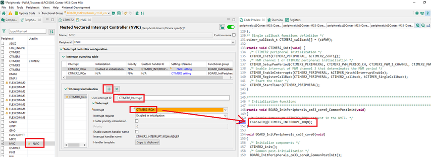

There is some bug in Config Tools for LPC55s69. Check box "Enable PWM period interrupr request" has no effect on the generated code. The last argument of the CTIMER_SetupPwmPeriod function is always set to false.
MCUXpressoIDE_11.4.1, MacOS.

I have analyzed the attached PWM test application but the generated source code is correct. You must understand that there are two CTIMER channels used for PWM signal generation. One specify the period and the second specify the duty. See the following screenshot that explains which interrupt is enabled and how it is initialized in the source code:
You can see that the channel #3 is used for the PWM period. The interrupt of this channel #3 is enabled by the CTIMER_EnableInterrupts() function call after CTIMER_SetupPWMPeriod() function call.

If the last argument of the CTIMER_SetupPwmPeriod function is set to false, interrupts in NVIC will not activate (screenshot in attachment). The code which you showed won't work!
If I add a line (eg in main): "EnableIRQ (CTIMER2_TIMER_IRQN);"
everything works fine!
So, tell me how can I enable (correctly) "PWM period interrupt" from Config Tool?
edit:
It looks like the CTIMER_EnableInterrupts() function will not call the EnableIRQ() function for NVIC.
25,946件の閲覧回数
marek_neuzil
Hi Daniel,
You are right. When the PWM period interrupt request is enabled only the interrupt vector is not enabled in the NVIC. The CTIMER driver API is not consistent in this case. It can be fixed in the CTIMER component (I will create an issue and I will fix it).
You can either enable the PWM duty interrupt request and in the callback function you must check the status flags to distinguish the channel (the value of the flags parameters contains the value of the CTIMER IR register) or you can enable the interrupt vector in the NVIC by using the NVIC component that is already in your project. See the following screenshots:

marek_neuzil
Hello Daniel,
I agree the solution I have proposed is just a workaround of the issue. The issue is caused by atypical implementation of the CTIMER_SetupPWMPeriod() function that enable also the interrupt vector in the NVIC (it is done due to interrupt routine in the CTIMER driver that provides callback functions).
I have already fixed the CTIMER component. When the PWM period interrupt request is enabled only the EnableIRQ() function is called to enable the interrupt vector in the NVIC component. This is the only solution I can provide in the CTIMER component now. Let me know whether you need a hot fix for this issue. I can provide a package for update of your local data.
I can report the problem in the CTIMER_EnableInterrupts() function but I am not sure if it is the right solution in this case. If the CTIMER_SetPWMPeriod() function provide configuration both channels (period and duty) both interrupts should be configured in this API functions. So the CTIMER_SetPWMPeriod() function should be updated.
