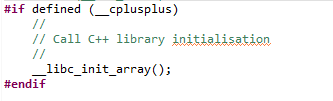

For C++ project, how to complete the constructors function call in start up file?

Hi @rodger_an ,
not sure if I understood your question. But you might have a look at my blog article on a related subject: https://mcuoneclipse.com/2020/07/11/from-c-to-c-converting-eclipse-c-projekts/
See the section about the C++ startup code.
The thing is that you can call the constructor initialization for global objects in the startup code, but this depends on the standard library used.

Thank you! ErichS.
Now I know the Cpp start up file . And know how to generate a ld script for C++ project.

Hi @rodger_an
You can create a function which call the constructor in main.c. Then call this function in startup file. This function must be called after everything initialized.
