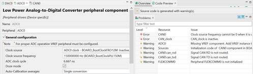

While we are at it, I just figured that enabling VREF is not checked when ADC or DAC is enabled in Peripherals Tool. I expected an error to pop up in Problems view similar to a missing clock, for example.
I suggest that the Peripherals team could look into making VREF a dependency. Does that make sense to you?
3,401件の閲覧回数
RaRo
Hello @danielholala,
Just for double check, instead of just having it like a warning related to the ADC after initializing both DAC and ADC modules, do you suggest it be shown as an Error like the CAN_clock in the following picture?
[Peripherals Tool and Problems view]
Best regards, Raul.
3,366件の閲覧回数
danielholala
Senior Contributor II
Hello @RaRo ,
Oh, obviously when I tested the VREF dependency of ADC in Peripheral Tools I tried this on a LPC5528 project by mistake. I just checked on a LPC5536 based project and now I see this warning regarding VREF, too.
Thanks for double checking.
Now the question is whether this notice should be at "warning" or at "error" level. As the ADC / DAC is not working without VREF enabled, I think this warrants an "error" level. Further, I suggest to add a "quick fix" (via context menu) to enable VREF, similar to the "inactive clock" error.
