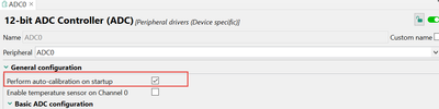

I recently moved from MCUXpresso 11.3 to 11.5.1. I noticed that my ADC isn't reading properly anymore. I have been using LPC54618 sdk 2.9.0 if that matters
I noticed that the auto-generated code in my project before upgrading used ADC_DoOffsetCalibration, and after re-generating my peripherals.c file, ADC_DoSelfCalibration is used. I then noticed that ADC_DoSelfCalibration is deprecated and when I switch back to the old function I'm able to accurately read the microcontroller's internal temperature sensor again.
I won't go into specifics of the combinations but I have tried regenerating my peripherals.c file with various combinations of MCUXpresso including 11.4, 11.5.1, and 11.6. I've also tried SDKs 2.11.1 and 2.12.0 in various IDE versions. All combinations of the SDKs and IDEs so far have resulted in the deprecated function.
Is there anything I can do about this or do I just have to manually edit the generated code each time I generate?
Thanks!

You can enable this function as below:
Alice

jared77
Alice,
I'm already using that to generate the code. The issue is that the generated code is using a deprecated function that doesn't work. Old versions of MCUXpresso generate code with the correct function while new versions use the deprecated function.

ADC_DoSelfCalibration() is the Deprecated function and has been from SDK 2.9-2.12 and maybe even before then, see my screenshot. I said in the last post the SDK isn't the issue, it's that the config tools are using ADC_DoSelfCalibration() which is deprecated rather than ADC_DoOffsetCalibration(). IDE v13 config tools generated code using ADC_DoOffsetCalibration() which was correct.
